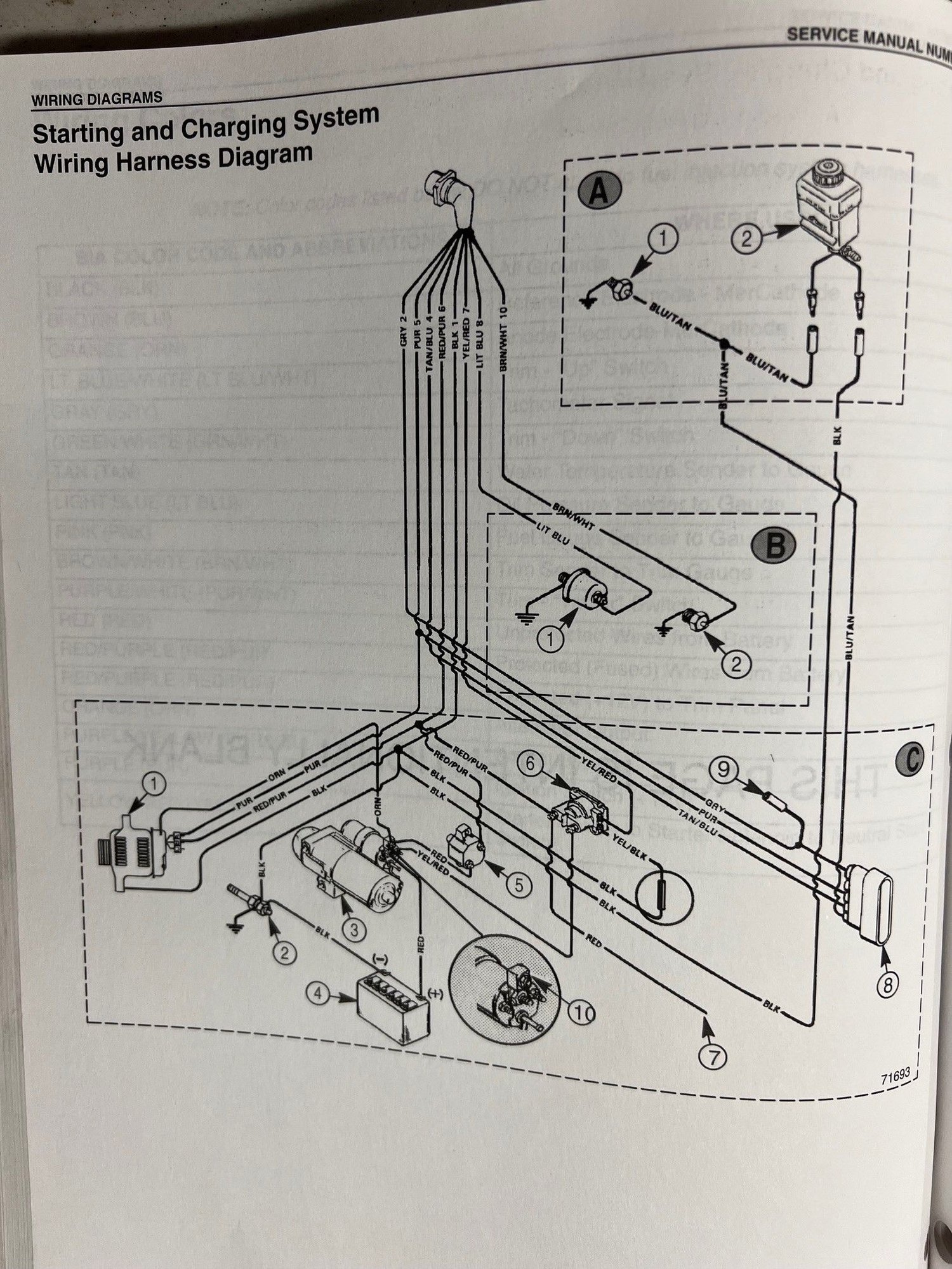

Don't the 500 EFI's use the engine coolant temp sensor and the MEFI3 outputs the high temp alarm? My manual shows Oil Pressure and Low Drive Oil the only two alarm switches, I think the rest of the alarms come from the MEFI.
