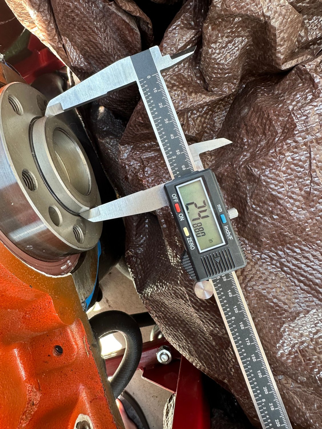

Batmeat 07-18-2024 10:43 PM
I’ll measure when I get off work tomorrow. I’ve got digital one I used to measure pushrods
BillK 07-19-2024 09:16 AM
Bat,
I remembered which customer was having the same problem. I just called him and his was a RAM flywheel also :( He sent his back and got a McLeod one that fit perfectly. I guess you will find out when you measure it.
Batmeat 07-19-2024 10:40 PM
Originally Posted by BillK (Post 4903423)
Bat,
didn’t get off work till late. I work tomorrow too. Gota measure it because all the flywheels are here. Hopefully by Sunday that mess will be over.
Batmeat 07-21-2024 02:17 PM
https://cimg0.ibsrv.net/gimg/www.off...85a44efe2.jpeg
there we go. 6.316cm in metric. The 1501 is correct. I love this forum! Everyone here is so helpful.
BillK 07-22-2024 08:46 AM
So the 1501 went on ok ? Glad to help :) :) :)
