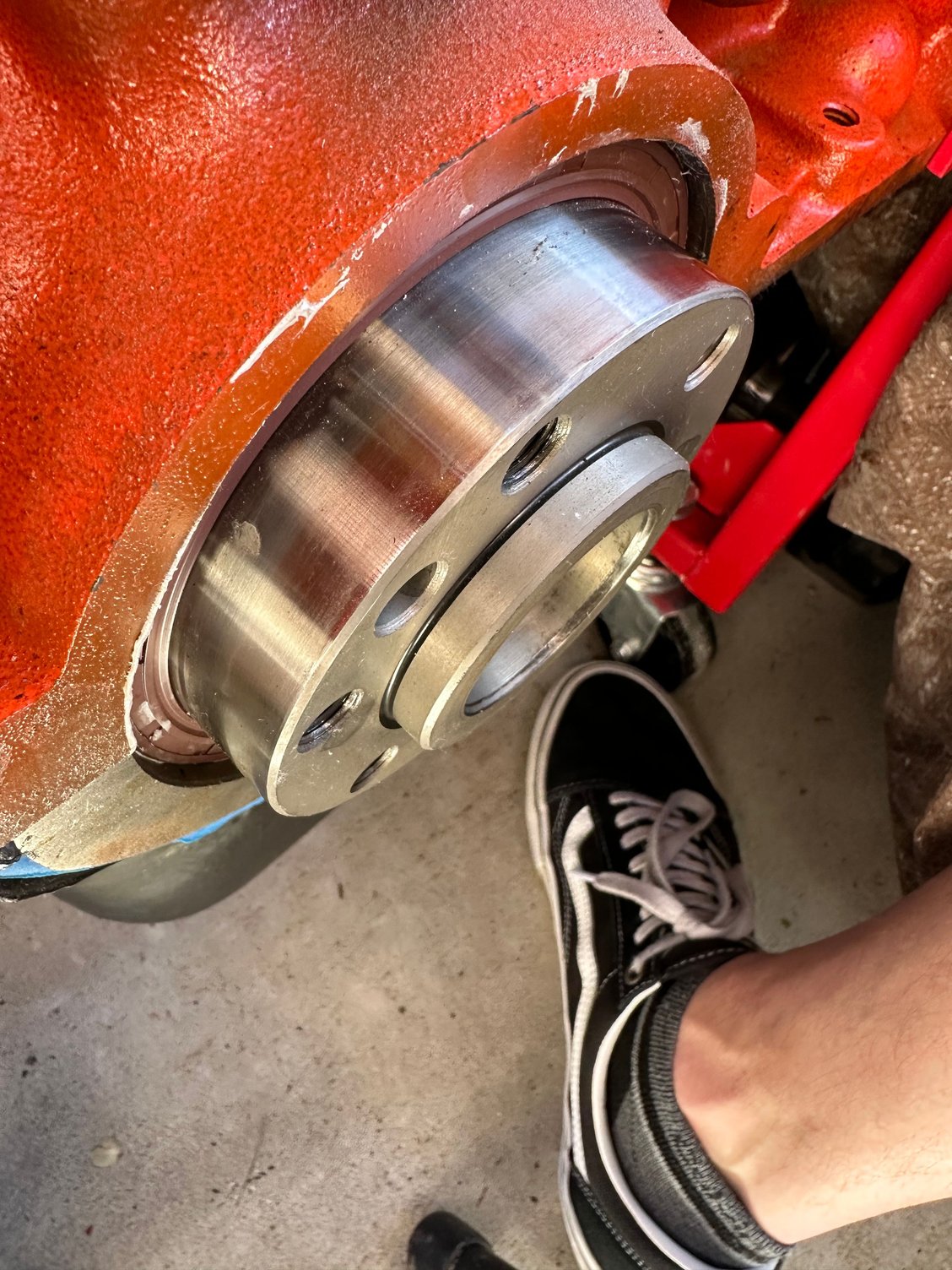

Finally warm here in Wyoming. I’m finishing the last pieces of the build. I ran into a problem though. Flywheel doesn’t matte up. Is there an adapter I need for an after market wheel ? No way it will fit over the ring in the picture .
as a refresher. Here’s the link for the 454 build. My wife went back to Mayo Clinic again but makes progress every day…albeit very slowly.
Flywheel is a ram billet steel 168tooth neutral balanced wheel.

You need a flywheel for a one-piece rear main seal. The one you have is for the older two-piece seal style crankshaft.

It's supposed to be for a one piece rear main seal. Here is what I got. Ram 1550 Also, I saw that one you linked is for external balanced engine. Mine is internally balanced. Not a big deal though.

I think I figured out my issue. I ordered one with a 0.4 inch larger center bore. Ram-1550X

The 1550X is an LS flywheel, not for a big block.
Pretty sure you need either a Ram 1501 or 1502 depending on if you want 30lb or 40lb. A stock GM flywheel is about 32 lbs. I actually weighed one today for someone.
The first two on this list:
https://ramclutches.com/ram-true-bal...let-flywheels/
well crap! I really should pay better attention.

For sure. I took my time. This is the flywheel I need. My motor is internally balanced.
