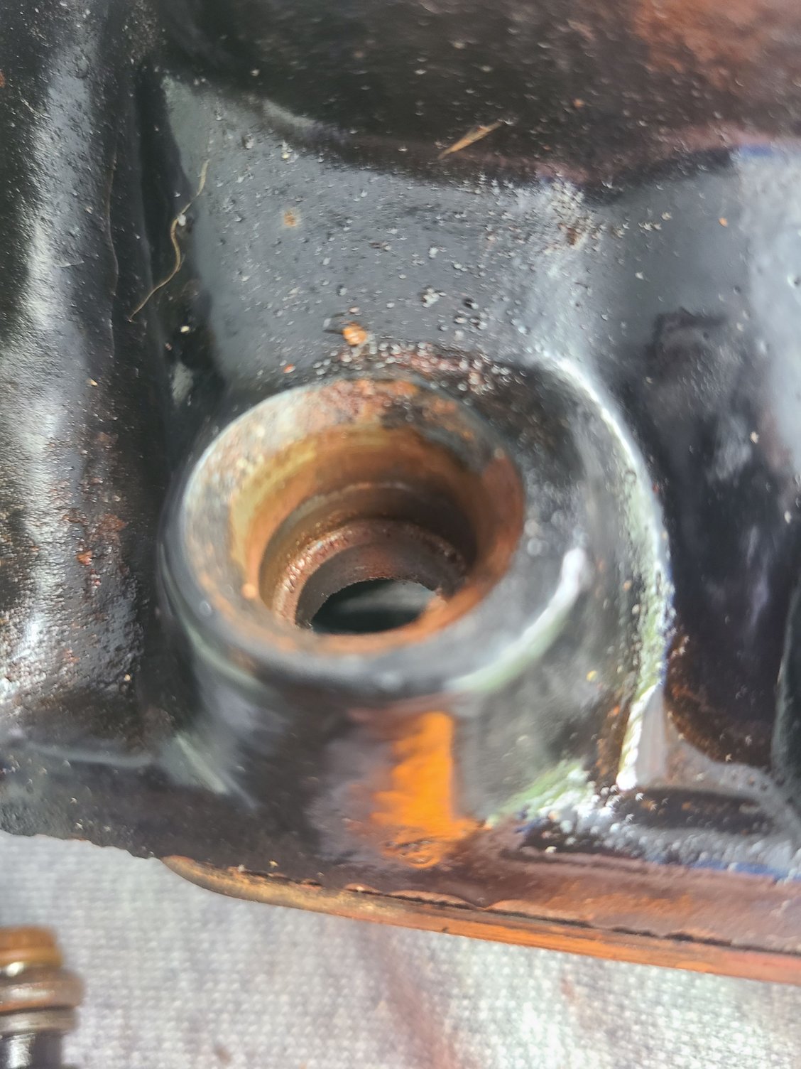

Ok, Articfriends and I have been chasing this down, his part of the project was simply to clean/test my injectors and he stepped up to assist in the Intake Lower parts issue and injector fitment between the two Lower intakes. To sum up, the newer PN Intake that I have and is rusted away is NLA. The older PN 8M0097032 is scarce but I may have located one that is reported (not yet confirmed) a different bore diameter (not sure if first bore or second bore) where the Injector sits.
We believe that the REPORTED bore size being different is incorrect and simply the Injector ID where O-ring sits is larger. Possibly, the last stepped hole is different but that should not be an issue as the diameter of the sealing surface may be the same. Both manifolds use the same Upper intake as well as fuel rails etc. The only difference I see is the Injector PN and O-ring kit. One Injector is 24 and the other 27lbs. Pictures (from one source) indicate that the injector tip is larger on the 97032 Intake mating injector but is unknown for the actual O-ring sizes OD is different between the two Injectors.
Clear as mud yet? I need a beer. The pic shows there are 3 dimensions involved, the tapered area, first bore where the injector seals and the bore exposed to the intake tract/runner. I have ordered the older 97032 intake and will update my findings.
