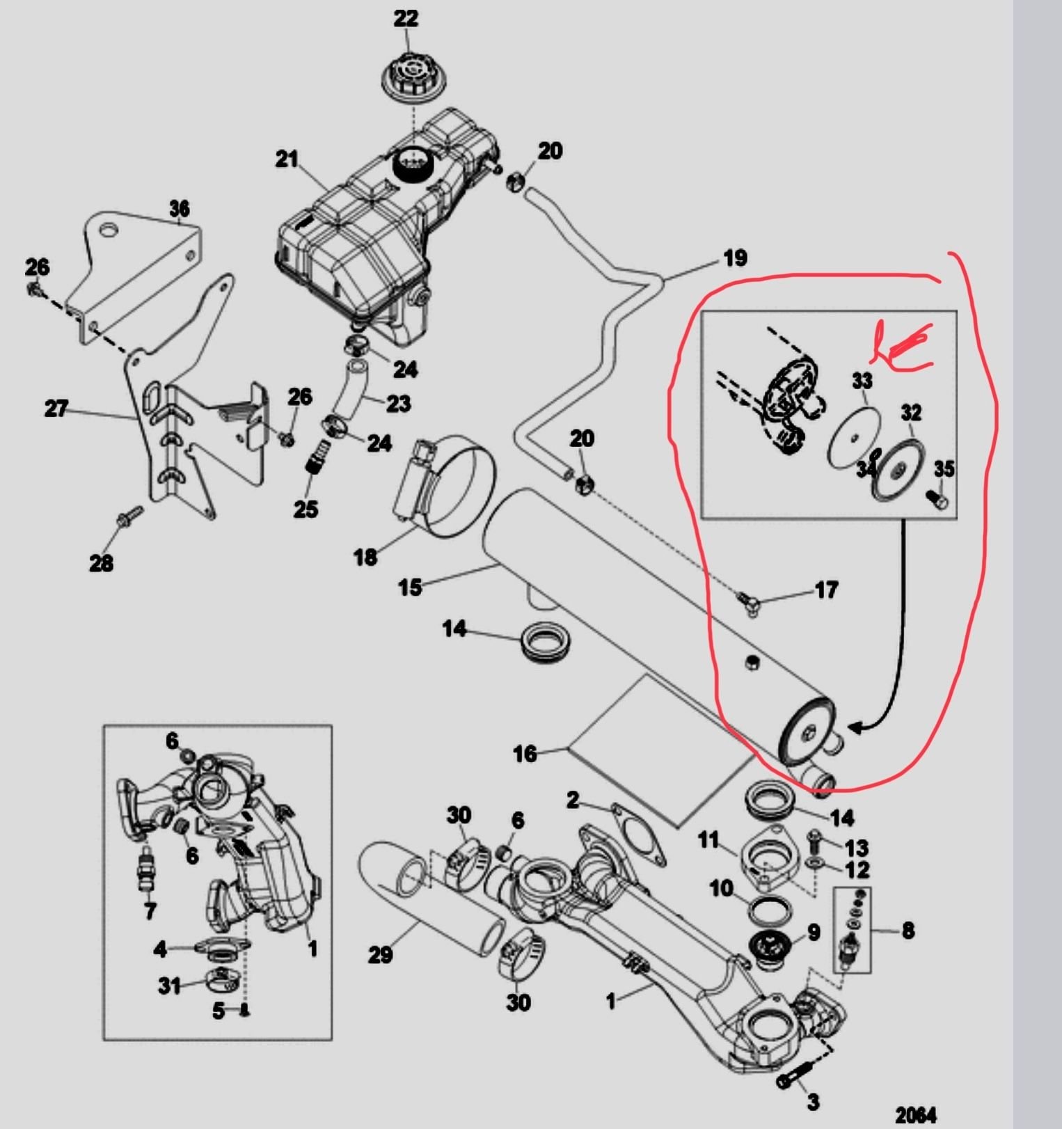

Originally Posted by underpsi68
Check the heat exchanger end plate gaskets. Known issue on the engines.
You should listen to this guy. I think he is right. I know that I just went through this today. On Friday I took a ride and at the end of the ride the port engine went to 200° and the red warning light lit up. Fortunately , it was right when we were in front of the dock. I quickly docked the boat and turned the engine off. Both water pressure gauges were at very strange readings too. I called the marina this morning and the came out immediately. The guys changed both impellers. We went for a test ride and nothing changed. One of the techs had just been through a similar issue with a formula. So, he checked the gaskets at the end of the heat exchangers. He showed me the gasket. It looked like a big glob of black glue and was starting to break up into pieces. They changed all four. My son and I just took a test ride. Both the water temp and the water pressure are back to normal. Simple fix and took about ten minutes for all four to be replaced.
