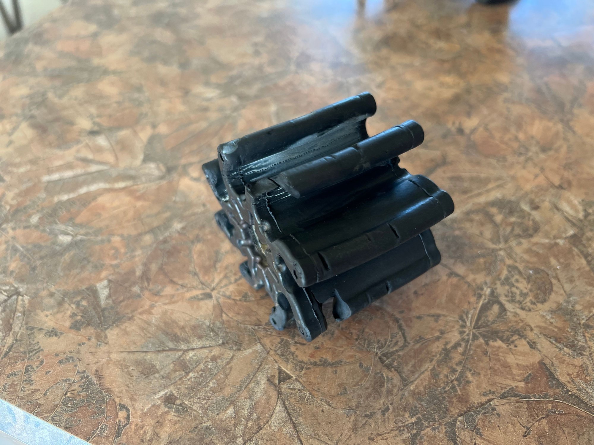

Don,
We bought the boat in 2021 and have had the seawater impeller changed once (whole pump, actually) since then. The impeller was seriously showing its age, but it was all there, for the most part.
https://cimg3.ibsrv.net/gimg/www.off...c00cdbf00.jpeg
This pic was taken in March of '23, and the temp thing didn't start until this season. I have no worries about bits of the impeller plugging up the works. I'm guessing debris or an ailing T-stat is the culprit. I have faith in the shop. I just thought I'd bounce the behavior off the minds here on OSO for any insight they might have.
Thanks. Brad.

Don_Juan 08-05-2024 04:21 PM
I believe it's common on a 496 port side exhaust to have less water output. Mine was like that when I first got it. Maybe a Procharger runs hotter, but my 496 with a Whipple doesn't exceed 160 after a run. I have the 120 stat recommended by Whipple. I'm at 140-145 at idle. You could be pulling air into the raw water cooling system. My boat had a transom fitting that went to the sea strainer so you could run it out of the water. I found the aluminum connector going into the strainer had corroded. I removed that flush line completely and put a stainless plug in the strainer bung. I took the hoses off the oil and fuel coolers and made sure I had no debris. I back-flushed. I took the ends off the heat exchanger, removed it and flushed it. I filled it with (I think) 50/50 coolant and distilled water and added two bottles of Redline Water Wetter, all as recommended by Whipple. I also upgraded to the $700 stainless Hardin impeller housing. You could have Bravo-itis or a hose clamp at the transom or one of the other water intake hoses that are not completely tight. My port side exhaust now seems to work as well as the starboard side. It may take a few seconds more on start up, but flow is similar and I do not have any steam. You may have to look at installing a transom pickup for your intercooler, if you're now feeding it off the raw water intake. To me, climbing temps indicates a worn impeller or housing. I would probably spend the money on the Hardin pump, I'm not a fan of the stock Merc pump. IMO, you have something going on. It could take a lot of time and effort to solve.
Brad Christy 08-05-2024 05:09 PM
DonJuan,
It’s a brand new (OEM) housing, as of last March, so I don’t think it’s worn yet. The impeller is suspect, though. Working that angle.
Does the Hardin impeller housing pull/push more water?
This…?
I don’t have a strainer, so that’s out.
Thanks. Brad.
Brad Christy 08-05-2024 05:11 PM
Guys,
Merc 496 raw water system
Can someone explain what’s where, as far as the general flow of water, in this?
Thanks. Brad.
