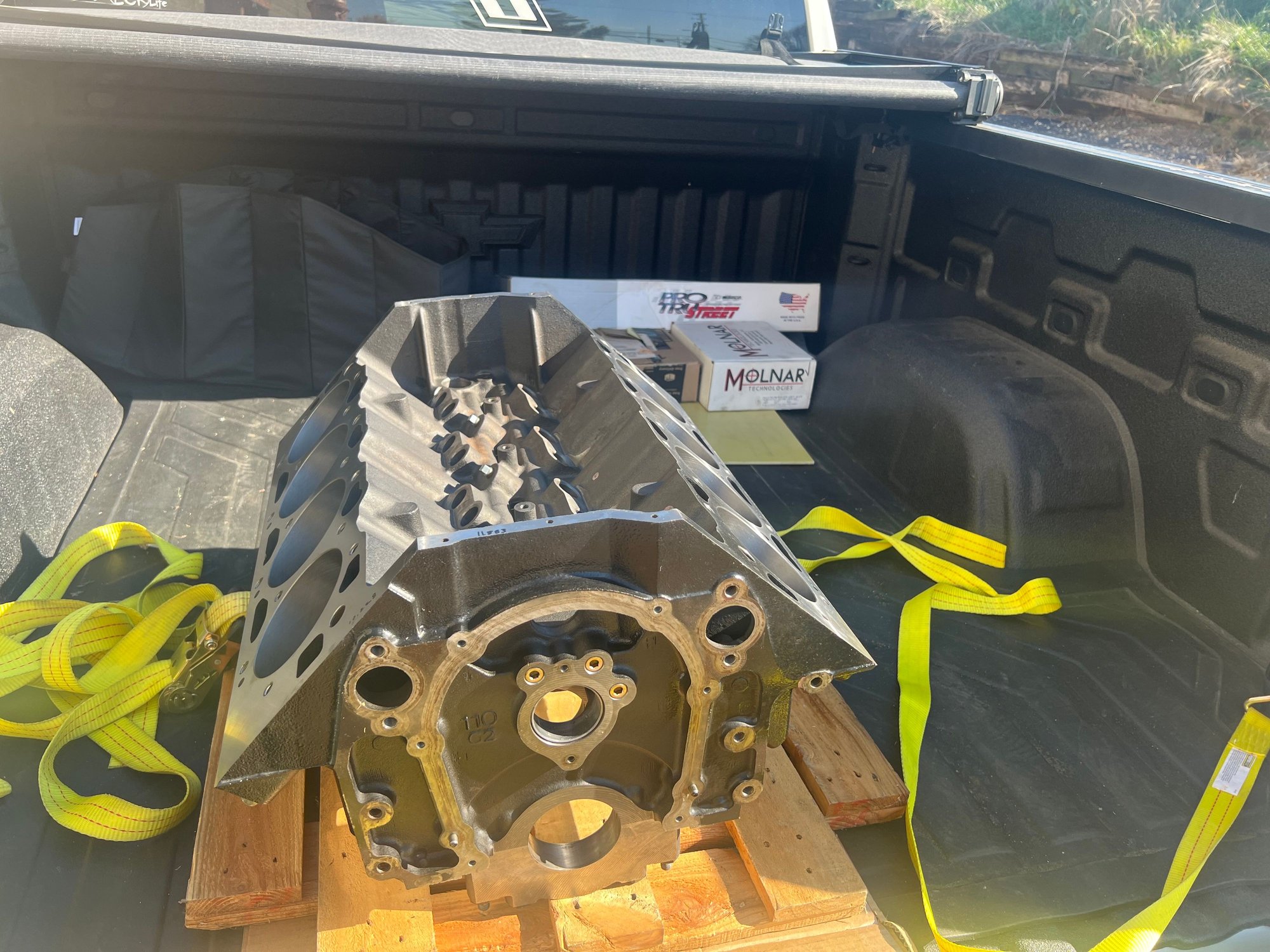

Guys,
https://cimg1.ibsrv.net/gimg/www.off...33d9ef13d.jpeg
A block and its internals. The crank is on the front passenger floorboard.

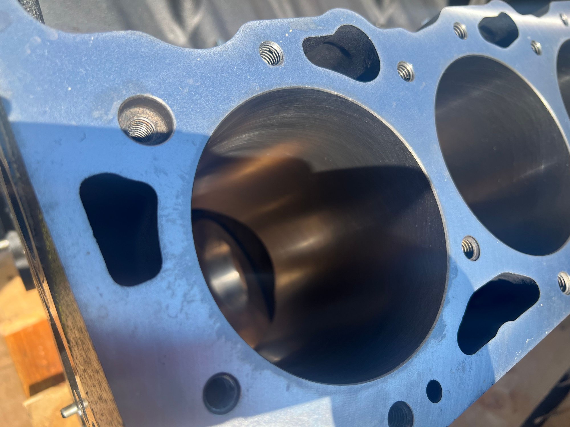

https://cimg3.ibsrv.net/gimg/www.off...fba09ce88.jpeg
Look at that hone….

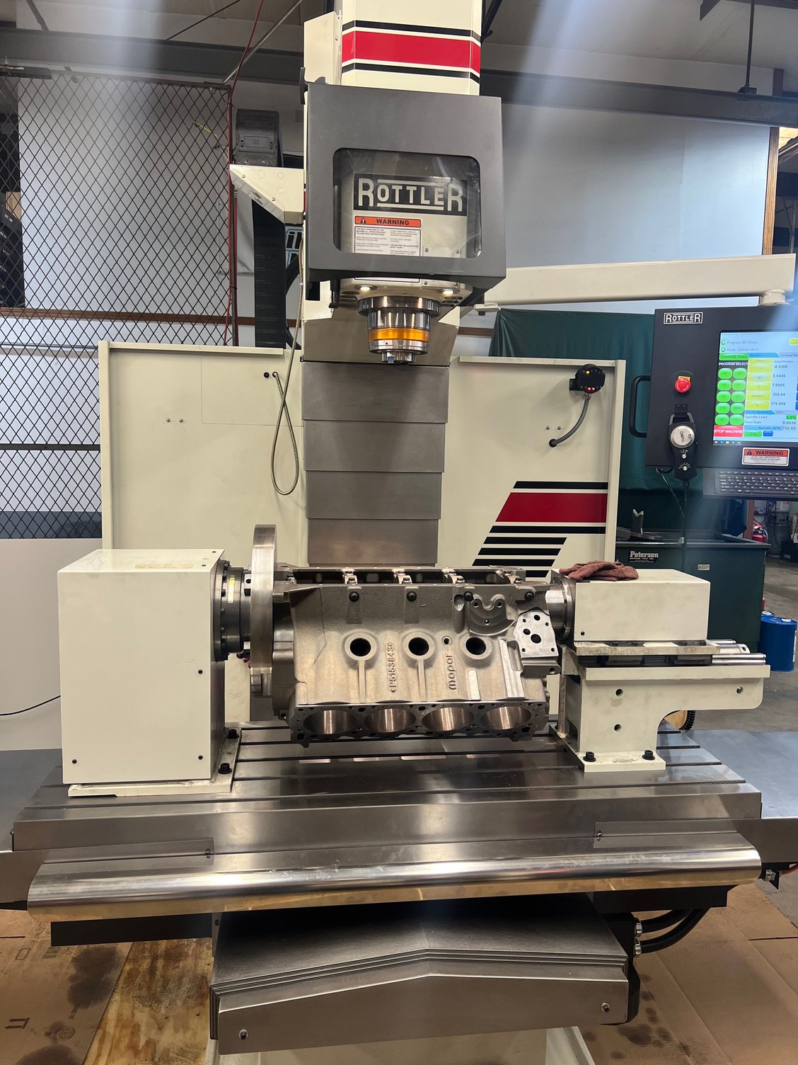

https://cimg5.ibsrv.net/gimg/www.off...f764c86ea.jpeg
The virtually brand new machine the work was done on. Nothing more than a 4 axis CMC bed mill, really, set up specifically to do engine blocks. But it’s still pretty cool. I didn’t get a pic of the honing machine, but it’s pretty cool, too. It can hold +/- .0002” size and taper. Again, pretty cool to me when my interests and profession intersect.

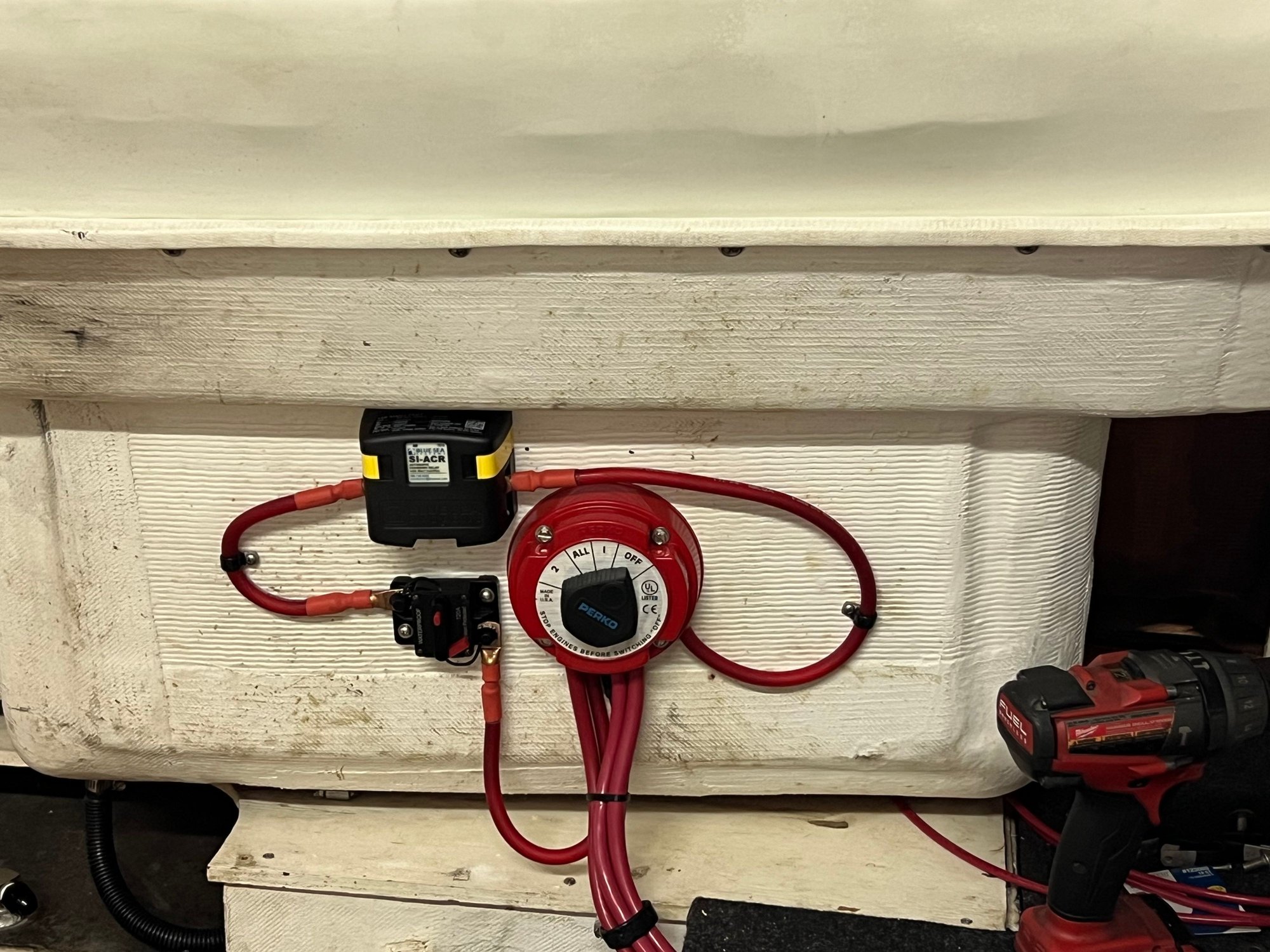

Also got the ACR circuit buttoned up today.
Starting to work on fuel plumbing next.
