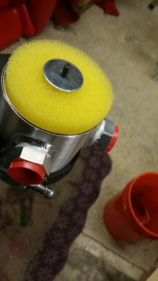

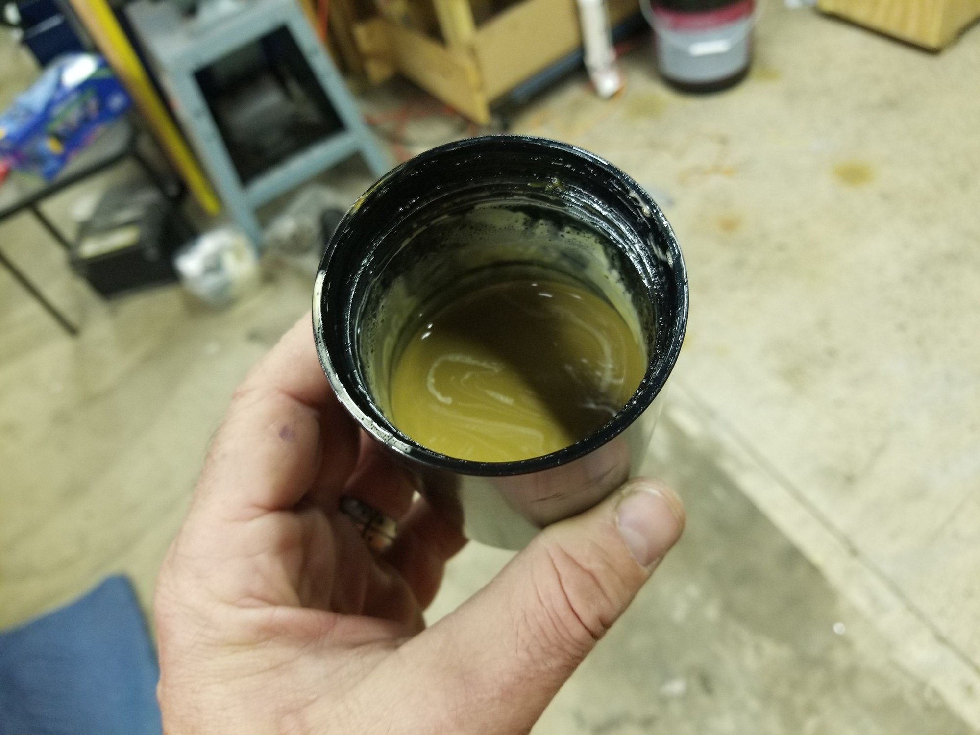

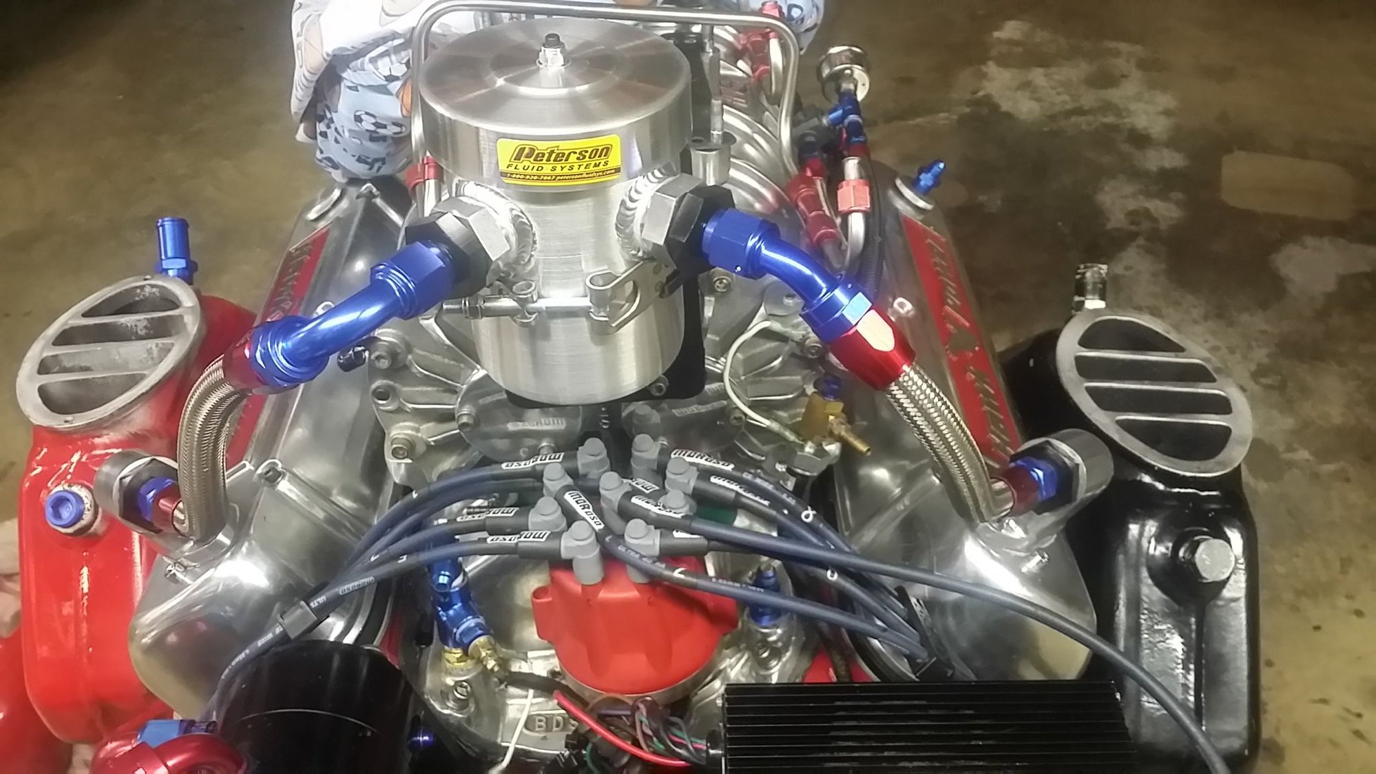

https://cimg7.ibsrv.net/gimg/www.off...f11f89ff6e.jpg
https://cimg8.ibsrv.net/gimg/www.off...d021483d80.jpg
https://cimg1.ibsrv.net/gimg/www.off...9fb34345b1.jpg
https://cimg6.ibsrv.net/gimg/www.off...11354dab47.jpg

That being said here`s my N/A LS3 catch can I added because I don`t want all this **** in my throttle body/intake. I empty that can on the vette every 2 months and it`s full.
https://cimg9.ibsrv.net/gimg/www.off...af75b05695.jpg
