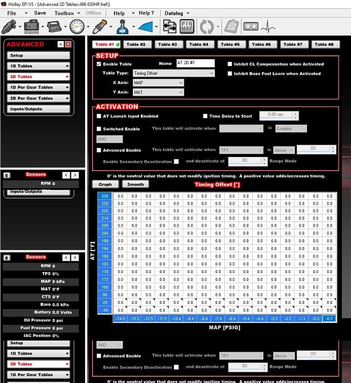

Setup a 2D timing offset with MAT vs MAP. Enter how much timing (-) you want to pull at certain areas of the map.
Example
https://cimg7.ibsrv.net/gimg/www.off...87abc686d9.jpg

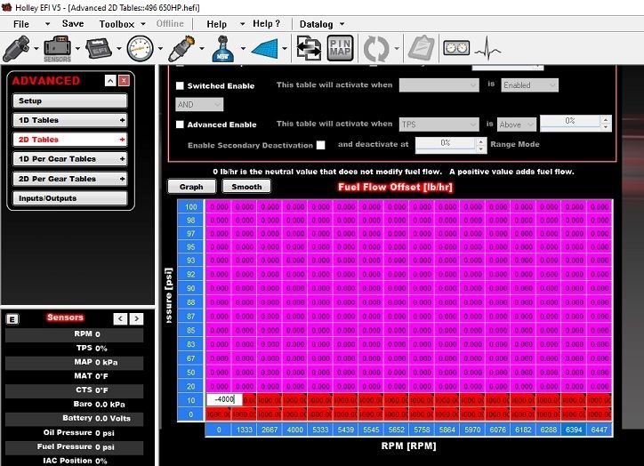

I do this for all of my safeties. If I have below 0-20 PSI oil it will wait 5 seconds and then pull -4000lbs of fuel. My engine will shut down
https://cimg2.ibsrv.net/gimg/www.off...4c81d7d0a2.jpg
TeamSaris 06-09-2025 08:24 AM
becareful with safeties. merc guardian mode will never ever completely shut your engine down.
our holley "guardians" limit you to about 2000rpm. reason being, you never want co completely lose control of your vessel. could be in a shipping lane, dealing with a current, or trying to avoid hitting the dock.
case in point, if my engine is overheating but im about to go over niagara falls- f@ck the engine, im getting out of there.
you want to know there's an issue sure, but keep it gentle. major power drop at high rpm can be lethal in the wrong boat. back out of the throttles hard in a cat and hang on tight.
we have used input/output to trigger a mil light or an alarm as well.

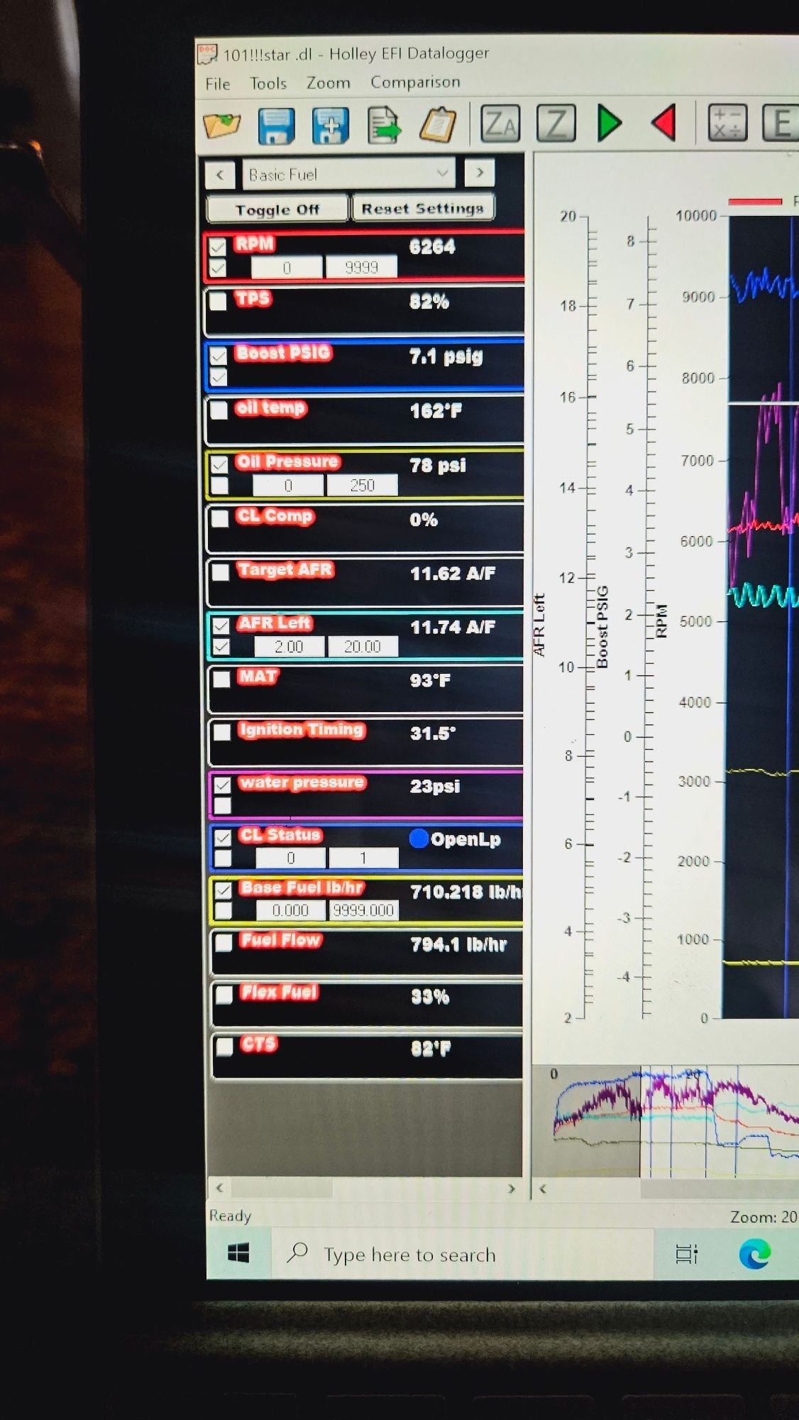

Holley data logs , very easy to bring all that data up:
I would pull data after every weekend.

Brad Christy 06-11-2025 01:42 PM
Originally Posted by ICDEDPPL (Post 4928115)
Why doesnt the 02 sensor read? To read plugs you have to start with a fresh set, go wot shut off , "read" plugs (I couldn`t ever tell anything ) then what about midrange how you read plugs there?
When there is a o2 available why not tune off that? It`s by far the most accurate annd super easy way.
Running open loop doesnt have the system account for weather, temps, etc it`s basically a carburetor at that point. The whole point of Holley(for me anyways) is to have it compensate from 1500rpm onward.
https://cimg6.ibsrv.net/gimg/www.off...a3d892222a.jpg
Dan,
Did you run yours closed loop? Ever have any issues losing WBO2s? I've always been told that one doesn't run closed loop in a boat because water will eventually kill the WBO2, and then you're dead in the water. Once the decision to switch to the Holley was made, the intent was to tune it and run it in open loop. Pretty much every Merc engine out there runs open loop. Would it be better to run closed loop, maximizing efficiency and output full time? Absolutely. But the juice isn't worth the squeeze in my opinion, nor that of the tuner. We've got it tuned safe; in the "rich" half of the "OK" range all around. We are going to run it this weekend and see how it does, then I'll touch base with the tuner and discuss.
The WBO2 reads just fine. We used it to tune the ECM with the tuner manually modifying the table as he watched the ECM correct from the base tune, holding his target AFR. It was really cool to watch him do this. He used the mouse pad with his index finger while he tapped on the number pad with his pinky and ring finger, manually inputting numbers on the grid where he saw need, based on the corrections he saw the ECM making to hold target AFR. The boat just kept running better and better. After a short convo between him and Smitty, he made an adjustment to the target AFR and we went through the process all over again. He was even making small adjustments to timing as he went. By the time he was done (about an hour total time), he was seeing nothing but 0% corrections from base tune, no matter what I did to the throttle. He accounted for weather, given the weather we typically see vs what we had that day. It was very obvious he'd done this many, many times.
