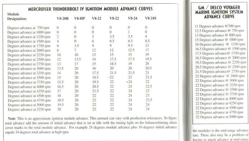

I dobt you will any difference changing modules, but here are the advance curves for all modules
