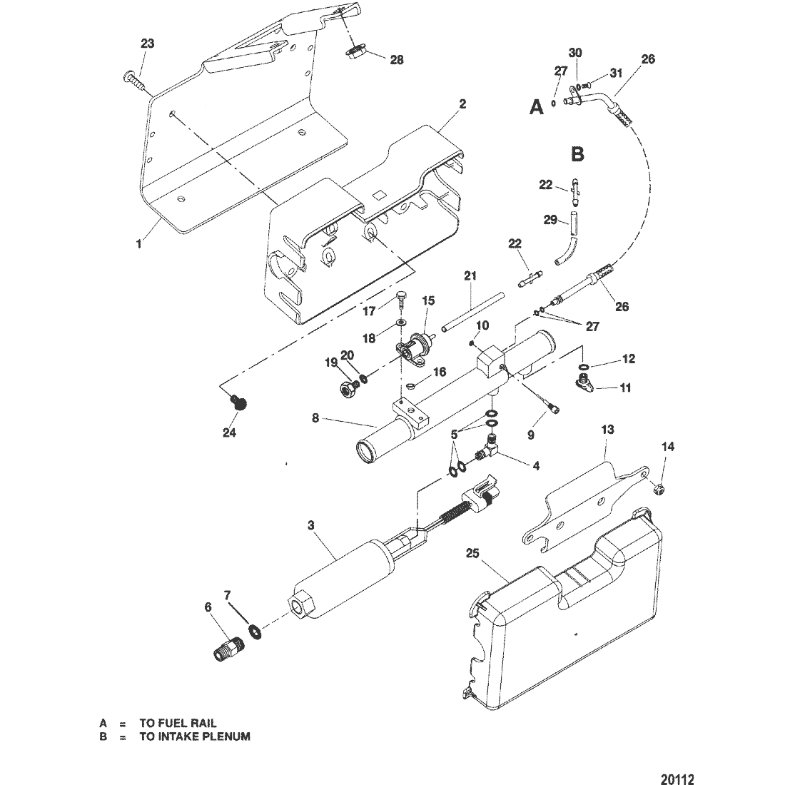

SubscribeI have twin 502 mags, later models with cool fuel on the side of the block, just replaced the fuel pump and regulator on one. Getting 70 psi at the rail, return line isn’t clogged and vacuum line isn’t pinched. Has anyone had this happen before? Don’t really wanna pull the motor to replace the regulator again. Any advice would be appreciated greatly

Did you put on Mercury parts or ? after market parts are like a box of chocolates
oem parts

Poor location design by Merc, are you testing pressure at the schrader valve and the gauge is accurate ? if so Id say you have a bad reg.

I agree with all Dodge. Anytime I get a high-pressure scenario on any motor, I check the screen on the return line 1st. It should be right under the regulator on most motors
