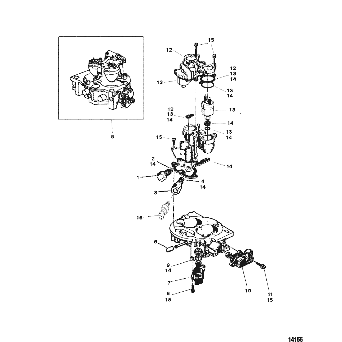

Is this your set up - has a fuel psi sensor (#16) in the fitting (#3) to the right of the fuel line inlet (#1)?
SB is offline
Old 11-11-2024 | 10:35 AM
Joined: Sep 2024
Posts: 22
From: Las Vegas
YES, This is my set up.I do have the #16 fuel psi sensor. You are the first person to talk about this, thank you for the insight. Could this be the culprit causing the issue and how does this work? Does it provide info to the ECM?

Thinking you maybe can put in a psi gauge (most are 1/8” npt) into the adapter the sender goes into.

I think it’s a 16 metric thread into the back of the TBI.
And after wasting $360 at a local shop, (they adjusted the timing and cleared a code and checked the plug wires were correct and also checked the fuel pressure which I already told them it was 38 psi) I decided to replace parts instead. Yes I know it isn’t the correct way but I’m down to 3 possible culprits: the coil, the fuel pump or the fuel pressure sensor on the back of the TBI. All 3 parts together are still cheaper than 1 hour at the boat repair shop. Yup, I’m frustrated but thanks for your help!
