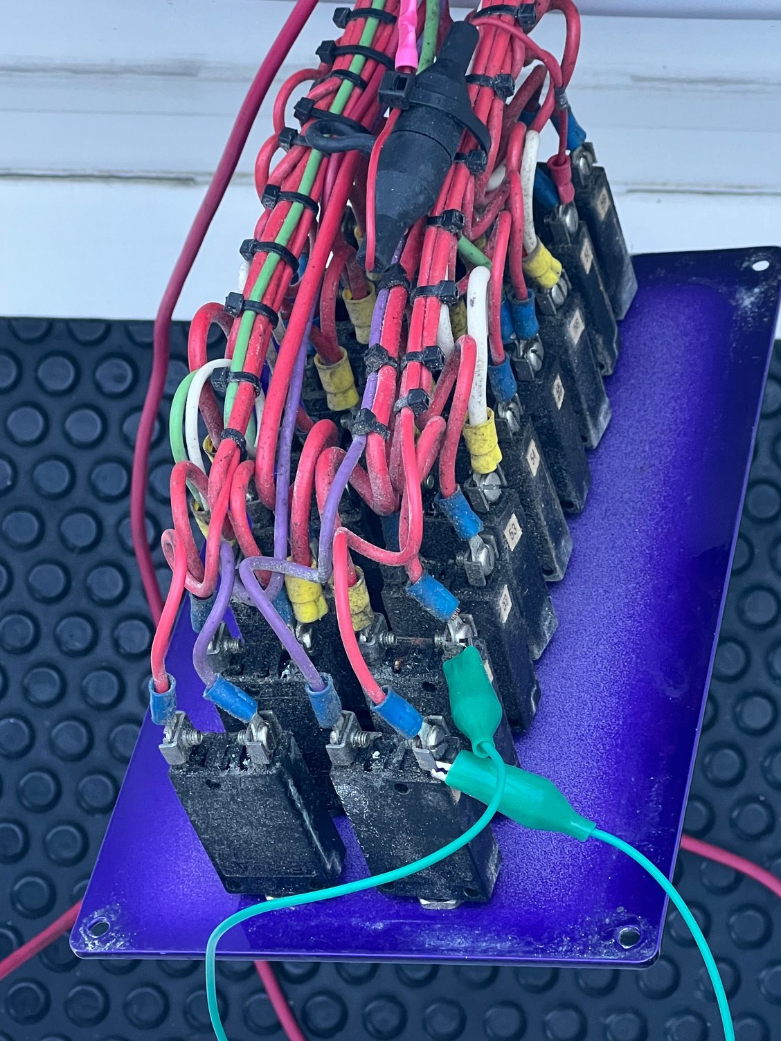

Made some progress. Pulled dash. Confirmed everything is getting power except ignition components.
pulled fuse panel…confirmed all fuses getting power except top 2 fuse boxes which is ignition components on purple power. Using a small jumper cable for power…giving that fuse power I was able to turn on fuel pump with key and push button for starter.
now I need to figure out why power is not getting to those fuses? Where does it come from I assume battery switches?
here is the odd thing. The fuse feeds a fuel pump switch on dash. We never needed to use those switches before. Which implies ignition was always hot to battery. Wondering if that’s a change that was made when this boat was converted to efi

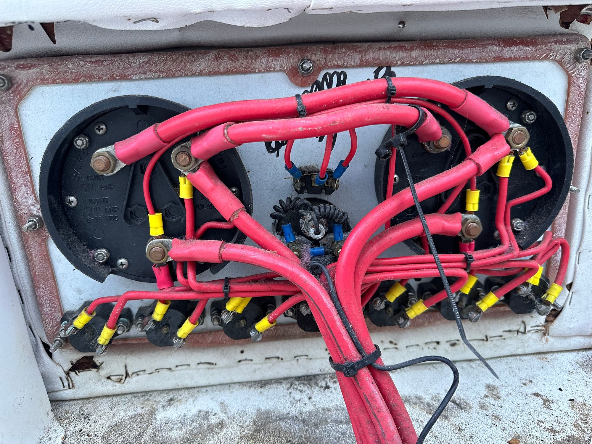

1MOSES1 11-05-2024 12:28 PM
Took battery selector apart…all wires tested hot.
for some reason that wire isn’t hot at the helm…

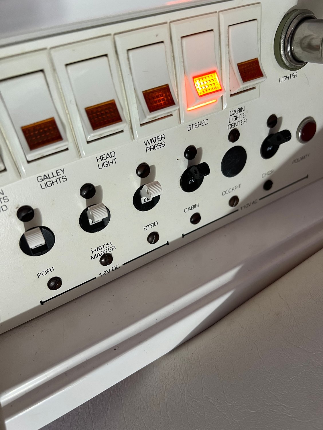

1MOSES1 11-05-2024 03:03 PM
Ok quick update. Power is not getting to starboard or port master switches in cabin. However it is getting to the hatch master. Which is in between them.
how is wire routed from battery switches to the switch area. I assume port side? I’m losing power between battery switch and switches in cabin.

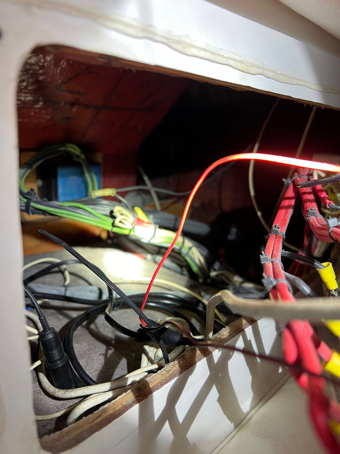

1MOSES1 11-05-2024 03:05 PM
https://cimg5.ibsrv.net/gimg/www.off...ddefd452c.jpeg
https://cimg7.ibsrv.net/gimg/www.off...b2758083b.jpeg
1MOSES1 11-05-2024 03:06 PM
The red wires run all the way back. Is there a bus they sit on from battery. If so where is it?
compedgemarine 11-05-2024 03:19 PM
so on the other side of the battery switch panel there are breakers at the bottom and a switch and gauge? in the middle. you have power at every single point there? is one of the circuit breakers power to the front switches for each side? not knowing how it was wired and just looking at pics makes it tough but if there are breakers in the rear that have power and then no power up front then it is in between which shouldnt have another connection point but who knows. with both failing is sounds like there is a hidden switch for theft protection or such in between that may have failed or was unknowingly turned off.
