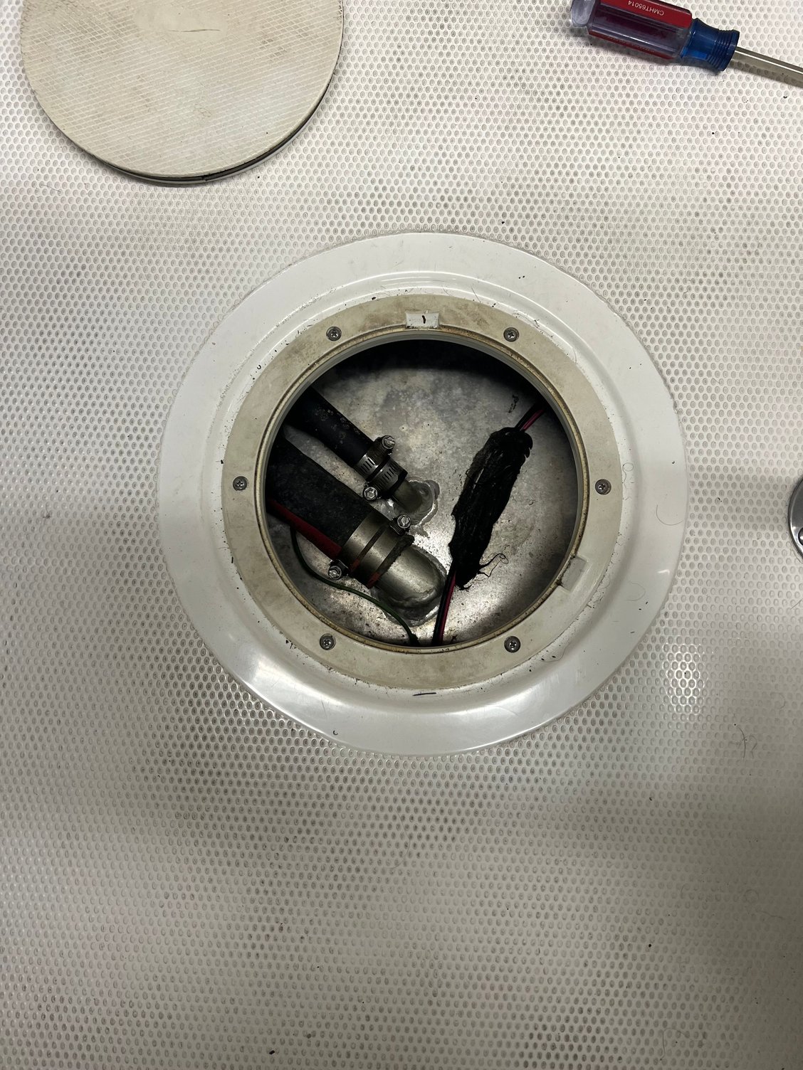

Rookie,
https://cimg5.ibsrv.net/gimg/www.off...6bbd6e78f.jpeg
I have access to the full hose on top of the tank, but I’m betting that hose would be a farqing nightmare to get off, and I’d have to cut it and use that cutoff as the splice between the tee and the fill bung.
Did you have a fuel cooler when your pumps ran hot while idling? I will have a cooler in my plumbing, between the fuel rail and the regulator.
Tyler,
Sorry for the slight detail, but this might be handy info for you, too.
Thanks. Brad.
Rookie 11-12-2024 09:52 AM
Originally Posted by Brad Christy (Post 4914448)
Rookie,
Usually this is T-d under the deck near the gunnel.
No, and they ran cool while underway without the coolers.
You should be good then.
Thanks. Brad.
See above...
