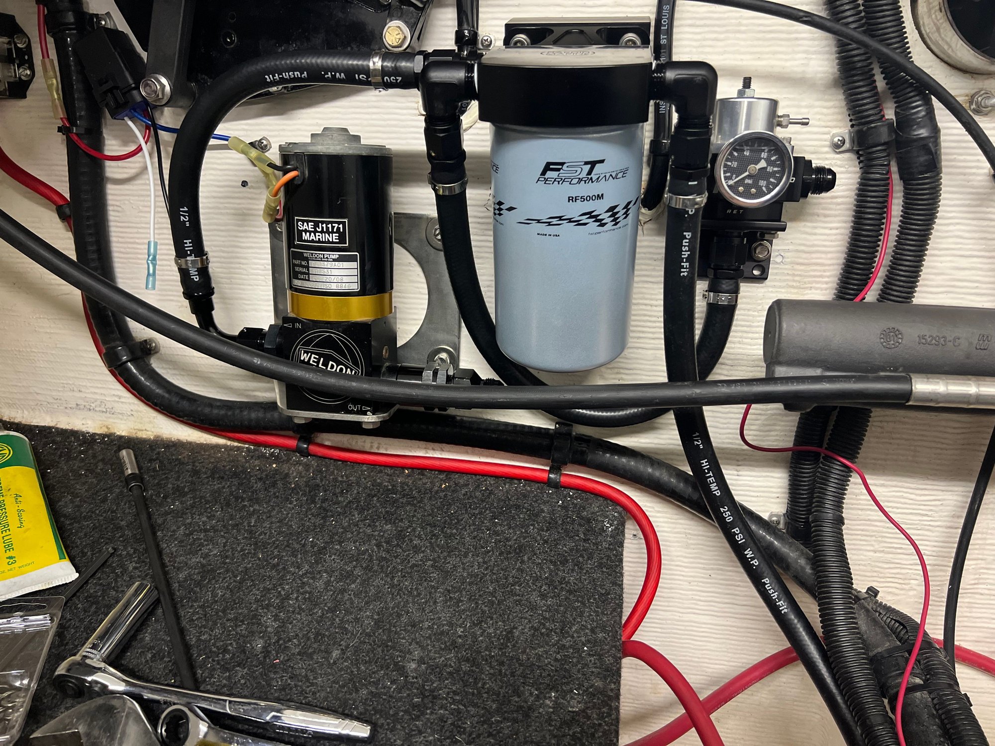

So this is exactly how I’ve got my fuel system set up. I’ve shared this photo with a handful of people, and nobody has mentioned a hazard of vapor lock. But, since you mention it….
(Older pic. I’ve since cleaned it up as best I could reach, and the pickup line is now AN connection.)
I obviously do not have a return bung on my existing tank, which is full-ish with fuel, and removal of the tank is an absolute non-starter. What would be the plan for adding a return bung if I wanted to go that route, or am I just stuck with it?
Thanks. Brad.
They make a "T" fitting that you splice into your fuel fill hose that will return to tank. I have friends that did not have the issues I had when returned to filter head. I was returning right before the pump bypassing the filter head. Circulating the same fuel over and over. My electric pumps would run hot. This was after 20-30 minutes idle time. You can always try it and see if it works.

Removing the return from the filter head and returning it to the tank was a proven fix for the 454 and 502 mags that suffered from vapor lock. Yours will probably be just fine since your lines aren't right on top of the engine getting heat soaked. You will just have to try it and see. As Rookie said, you can always return it through the fuel fill hose with a tee. I have also pulled the fuel sending unit and drilled a hole through it to fab up a return when the fill hose wasn't accessible.
