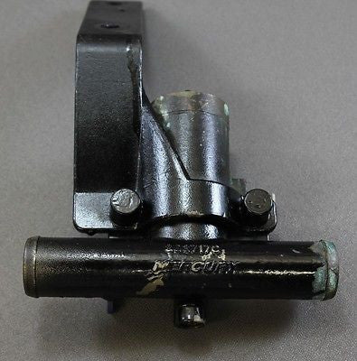

There are two air drain actuators. You can delete and remove them, and replace them with 1.25" diameter pieces of pipe. I used to carry a length of pipe in case one of them malfunctioned. There are two on each engine, one starboard side aft, one port side forward. This is what they look like.
But before you delete them, WHY do you want to delete them? Are they leaking? They make a rebuild kit for them.

If you are talking about the ball drain vales for the manifolds themselves, mercury sells a manifold conversion kit 866178A02 for your earlier water rail style manifolds that includes these new 1 way ball valves:
