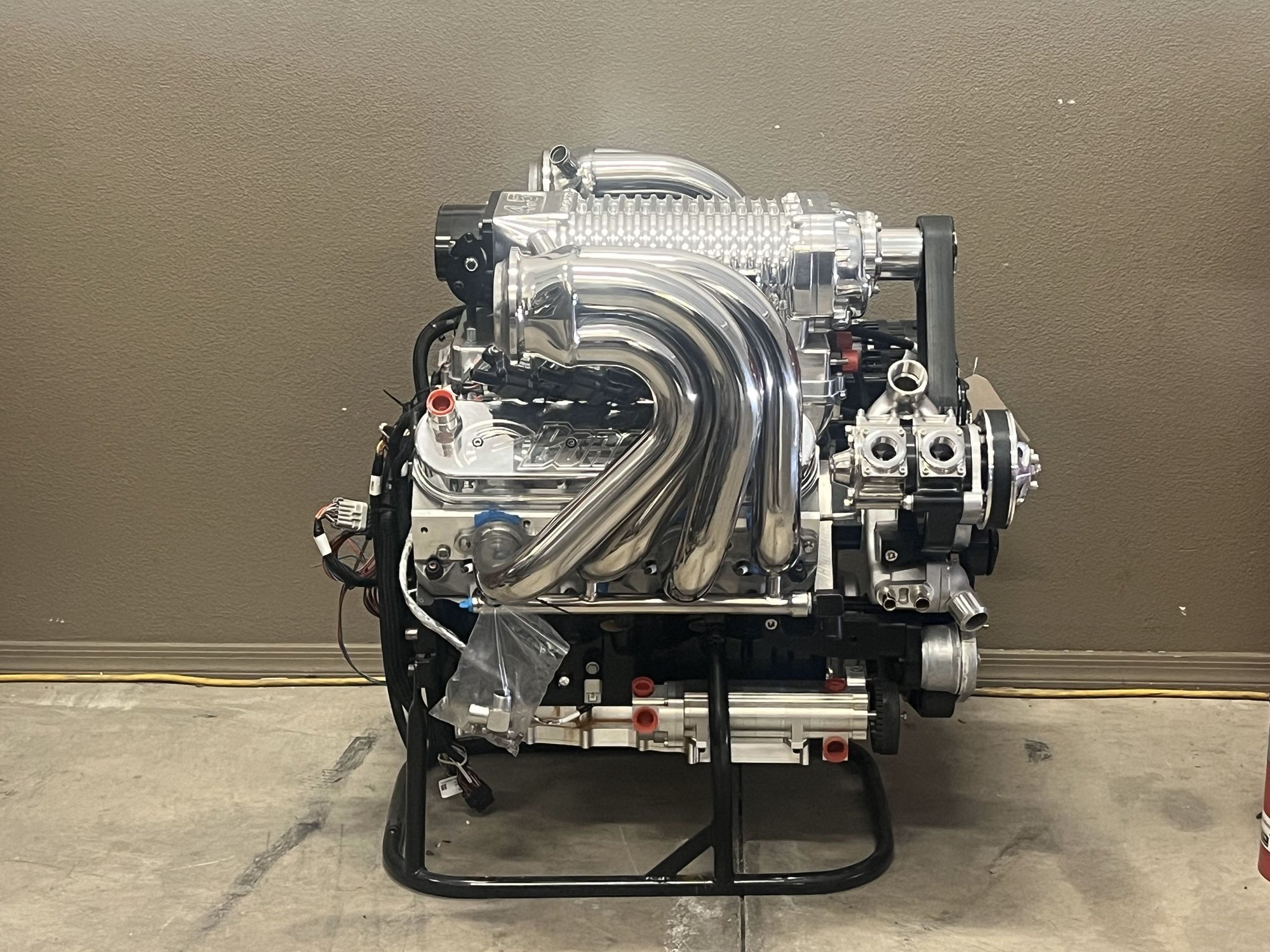

Not a 8.3 but a 4.5 Whipple on a 7 Liter LS. Don't think a 8.3 is warranted the new Revs of Whipple's are more efficient.
Definitely Whipple. Newer Tech and features Not a 8.3 but a 4.5 on a 7 liter LS 1325hp/1160tq. a stout piece for a new project.

Dont know how well that two stage pump mounted that high will perform
You are exactly right. That is where Ken had it mounted and he is not a boat person, it is going lower. Totally wrong for a boat.
As for Gay Ken he is following the money. LS is better these days to a BBC. I have to agree so that is why there is a LS in my future. LS 1325hp 427cu/in. to old BBC 570cu/in quadrotor 1400hp. plus the weight. got them both just in different platforms.
Have to say the 4.5 Whipple is taped out on the 427 @1325hp running 18000rpm@21psi with meth. It can not run a 570cu/in plus at that level. Even a 5.0 or 8.3 is the same supercharger just run from the opposite rotor. 16000 to 12000 rpm I think is maxed out as well on bigger cu/in motors.

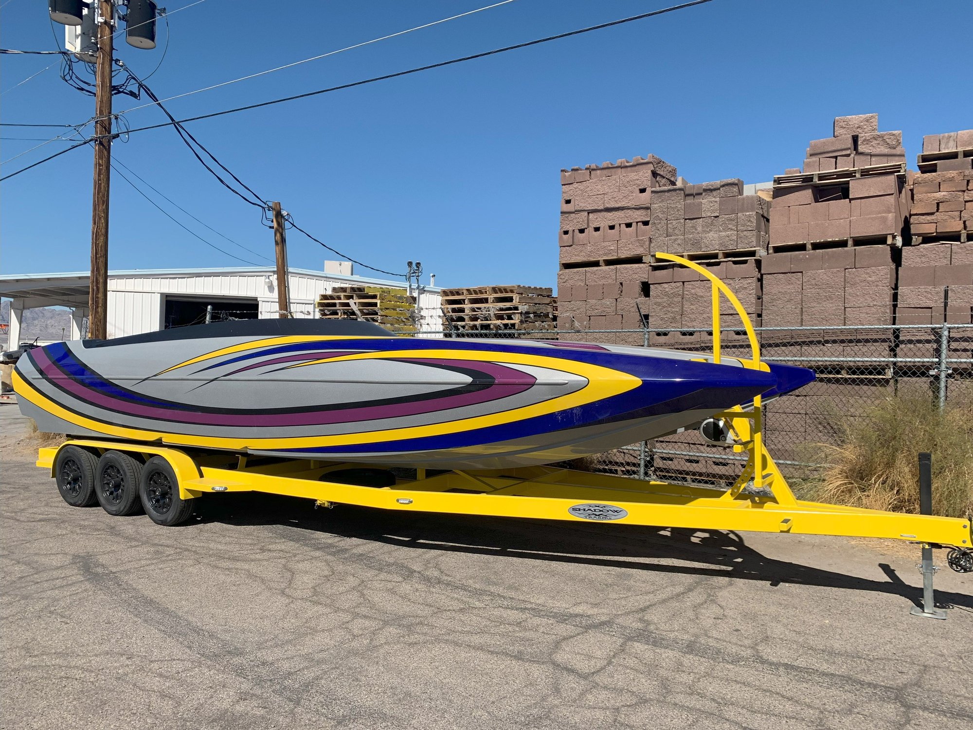

This is the 28 foot hull ready for rigging in Havasu.
