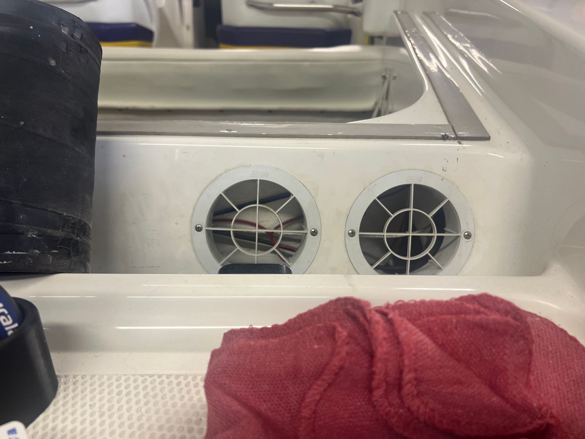

I`ve had vented hatches and would use the blower wiring for underwayter lights at 2 amps x 2 = 4 amps .
No issues.
I don`t understand your vent tube routing so.. you don`t have one IN (under engine generally) and another OUT to outside the boat?
Dan,
Pardon the mess. It’s a construction site, after all.
There are two of these on either side. The two on the port side have vent hoses connected on the underside of the gunwale, the outer one going to the bilge blower, and the other going to the bilge, outside the engine mount stringer. The two on the starboard side are just open to the engine well. I plan on venting the new, second bilge blower through the outer vent port on the starboard side. The inner one will remain open, I guess, as I don’t intend to blow another 4” hole through the inner gunwale like it is on the port side, and it’s a bit tight between the outer hull and the inner gunwale (I’d assume that’s why they cut the hole in the port side.
I will have to do something about those wires, though. Don’t think I ever noticed them before. I must have unsettled them during all the rummaging around redoing things in the engine well.
Thanks. Brad.

I've added a 2nd blower to both my Bajas and after reviewing the amperage draw (less than 4 amps each) I too just spliced into the existing wiring. No problems on either boat. I also like the fact it is pulling in twice the air now, from a CFM perspective, for the times when I am idling around. IMHO it definitely keeps the engine bay cooler.

Looking at all my options, I think I am going to splice in at the output of the switch and run a 12v to the new blower, then ground to the strap at the transom. It will still be a total 5A through the switch (well below threshold), but I won't have to dismount the old blower or cut into its wiring.
I also like the idea of increased evac during idling, helping to cool the engine well after running. Bonus!
Thanks. Brad.
