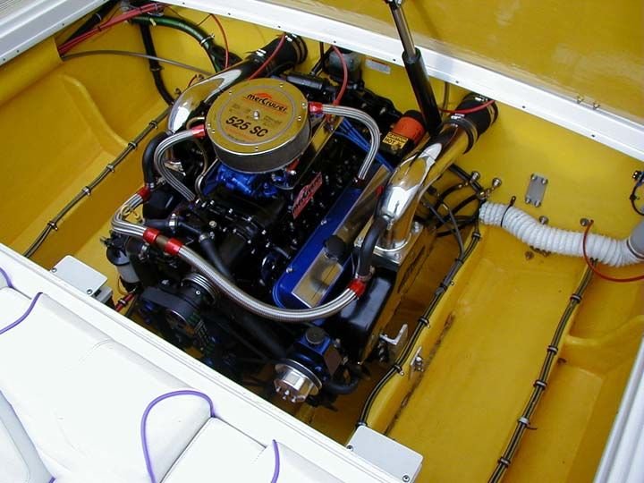

Yeah and Merc actually changed the Gil tailpipes from this style to the ones that are taller and have more swoop
https://cimg9.ibsrv.net/gimg/www.off...c9c26d3b5b.jpg

Griff 01-28-2025 03:29 PM
A 168731 won't have reversion issues with full length wet exhaust tails like the ones in the pic on my 525SC. The water mixed into the exhaust about 2" before the rubber hose connection to the exhaust tips.
