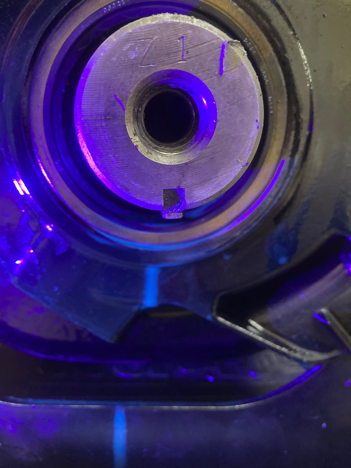

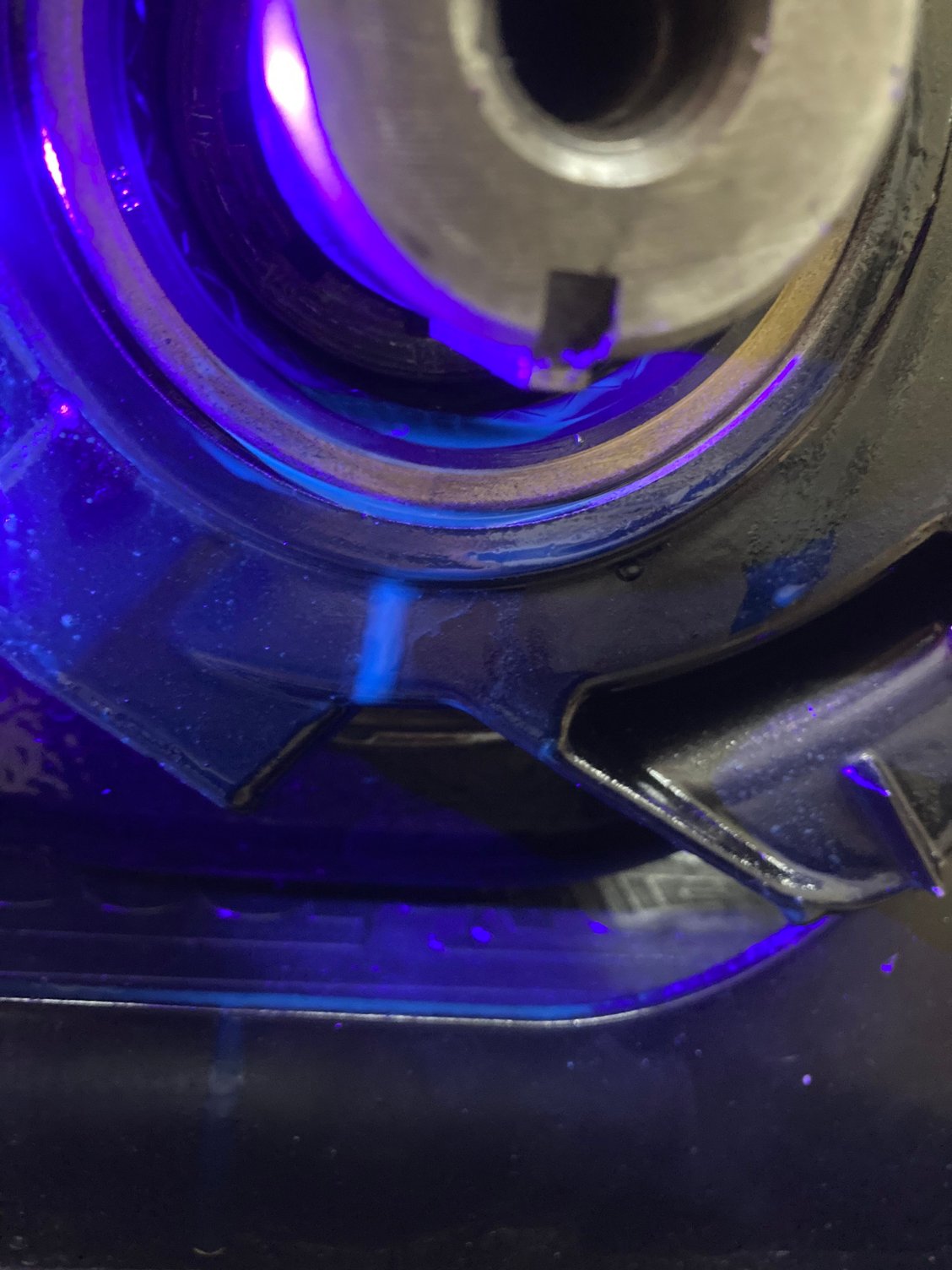

How common on complete rebuilds are oil leaks from the front timing chain cover seals? Reason I asked I had 2 engines completely rebuilt and both engines leaked around the front seal. I my past experience seals are relatively easy to install. These were leaking as soon as we put the engines in the boat, but it was said they didn't leak on the dyno. Also I'm not talking just a drop or two over the weekend, more like 1/4 quart over the weekend (which makes a terrible mess in the freshly painted bilge). I'm not going to mention the builder right now, just wanted opinions. Yep you guessed it, they won't answer calls or text.

You're talking about the seal around the balancer correct? The fel pro ones that were great for years are now trash. Dont know why. We switched to cometic and never had another problem. I replaced two fel pros on the dyno last year. Another builder and good friend of mine has had similar issues. Also, it helps to keep the timing cover loose when you install the balancer so it centers itself correctly. Tough sometimes depending on the cover and how tight the dowell pins are. Almost impossible with a Gen VI block.

Yes that’s he one. Here’s a couple pictures.

I think we are good now. We replaced both seals and everything looks good.
