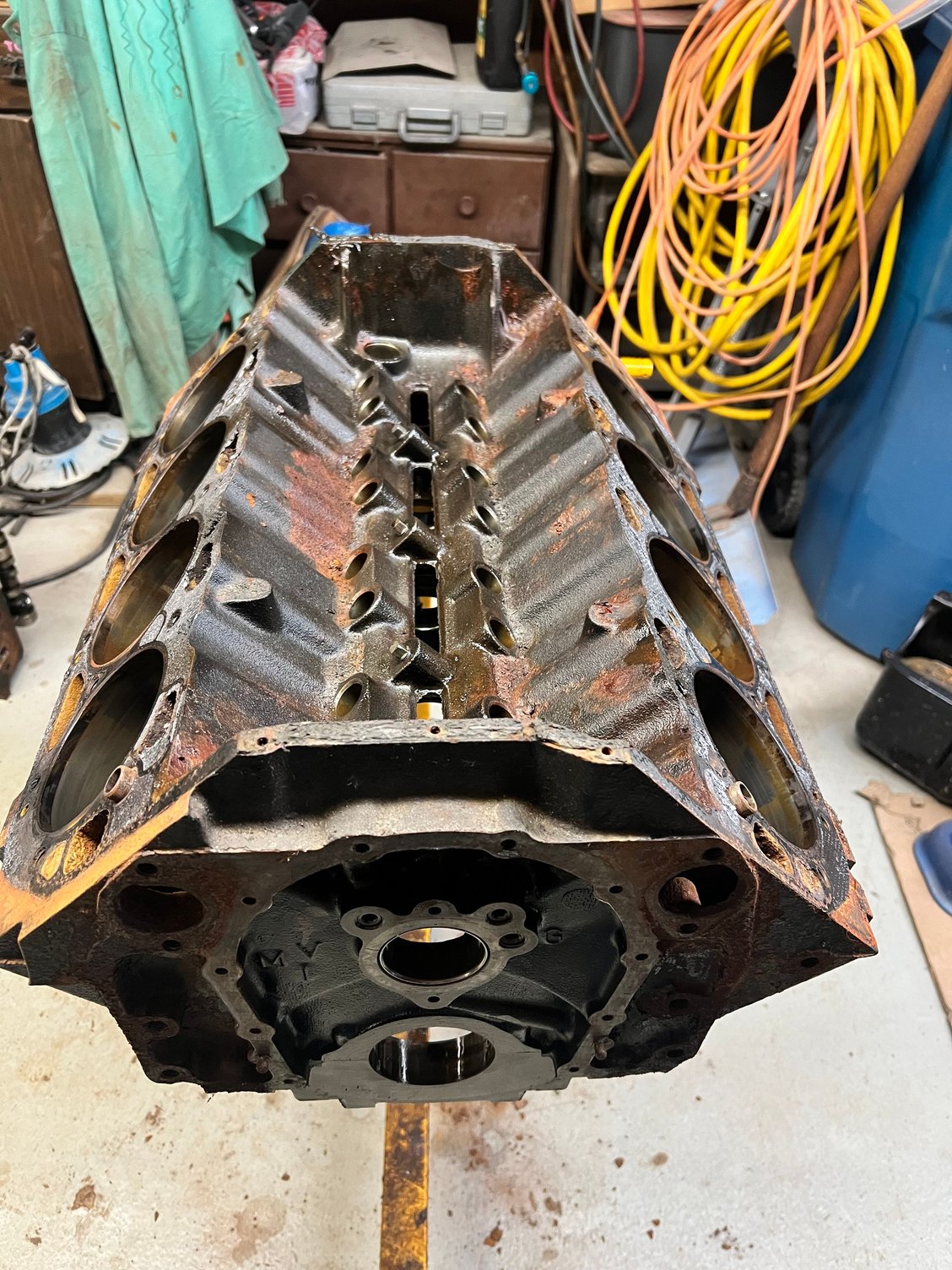

Old 05-11-2025 | 09:25 AM
Joined: Nov 2013
Posts: 834
Likes: 63
From: The pinnacle of awesome
Originally Posted by TomZ
All the blocks I’ve seen already have the bosses drilled. I believe they used them with gear drives in the heavy duty market.
gen5 I took apart yesterday. Came out of my 94 top gun.
ham_r_down01 is offline
