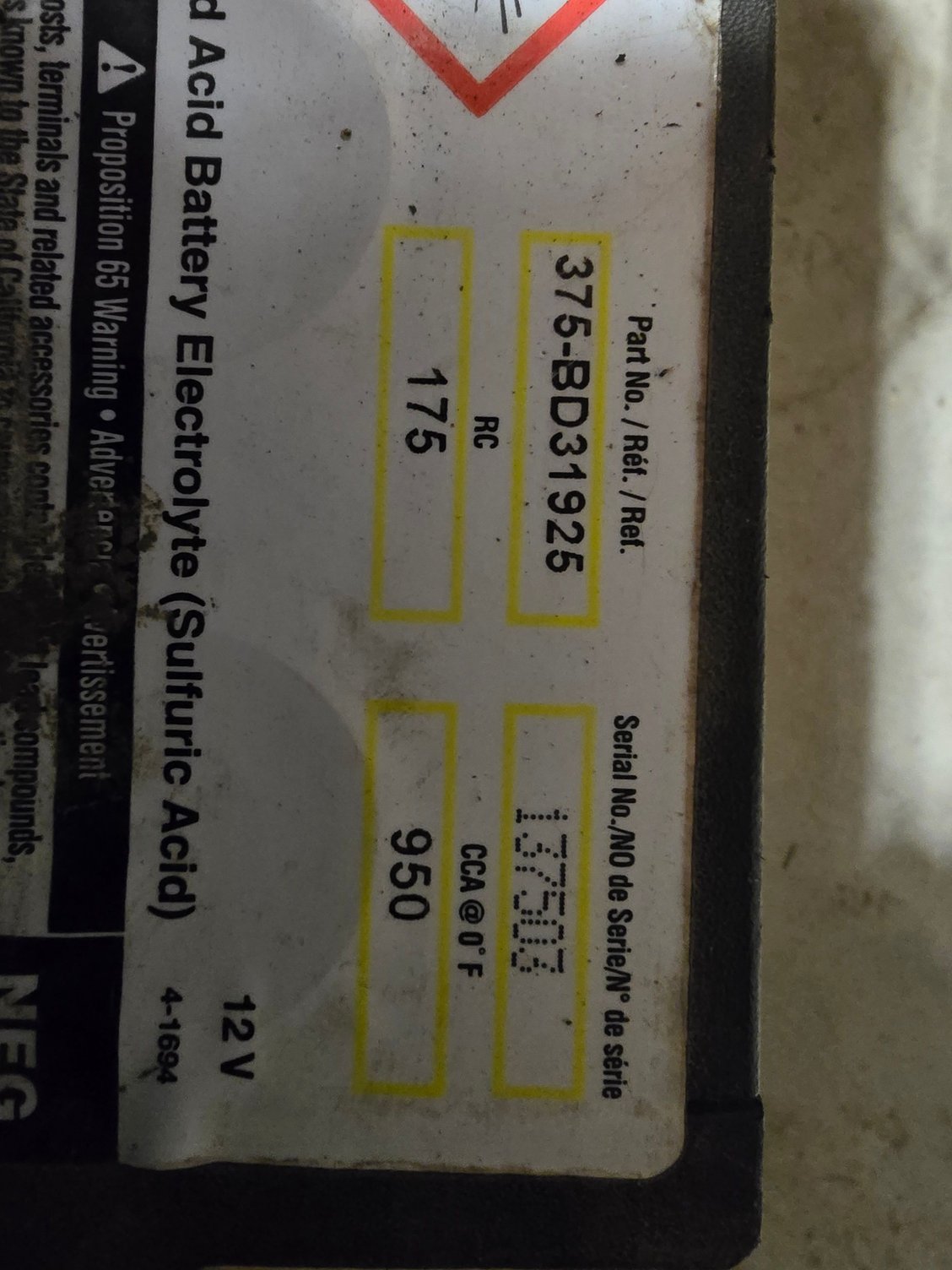

I bought my Hitachi excavator in 2011. They 12v batts were not new. They're in series for 24v. The 4 cyl engine is not that big, about a 60hp diesel. I've ressurected them from dead a few times over the cold seasons. I'll likely replace them next season as maintenance. Insane life on them.
I have Mack batts in the Mack dump tandem axle dump truck. 12v. I have 2 in parrallel. I've had just one in, and was strong enough to start the 673ci inline 6 diesel.
I've had these since Dec 2017, and they gave out their last gasp last year. I didn't use them much from 2020 to 2024 though. I had a current draw in my system that dropped them down hard...they recoverred well.
My plan is to get new ones for the boat...and then switch them to the machinery after 2 years. Buy new for the boat.
950 cca
13" long
8-5/8" tall
6-3/4" wide
