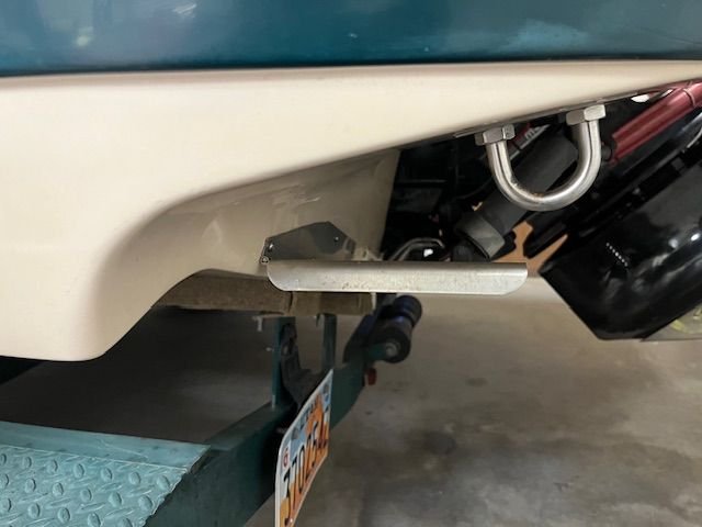

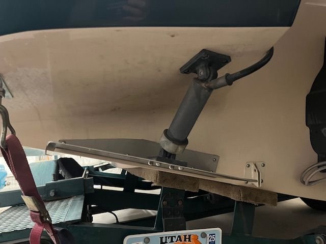

Can you share a photo of the trim tabs on the back of the boat? I have the same boat but the cuddy cabin version that I am working on for someone and they asked me the same question you just did. However they said they see 45 ish.
That boat has no good location for tabs and when I looked at the boat I have in front of me, the tabs are mounted 3/4” up above the water line, but they are always dragging on this boat when they are fully retracted, about 3”.
