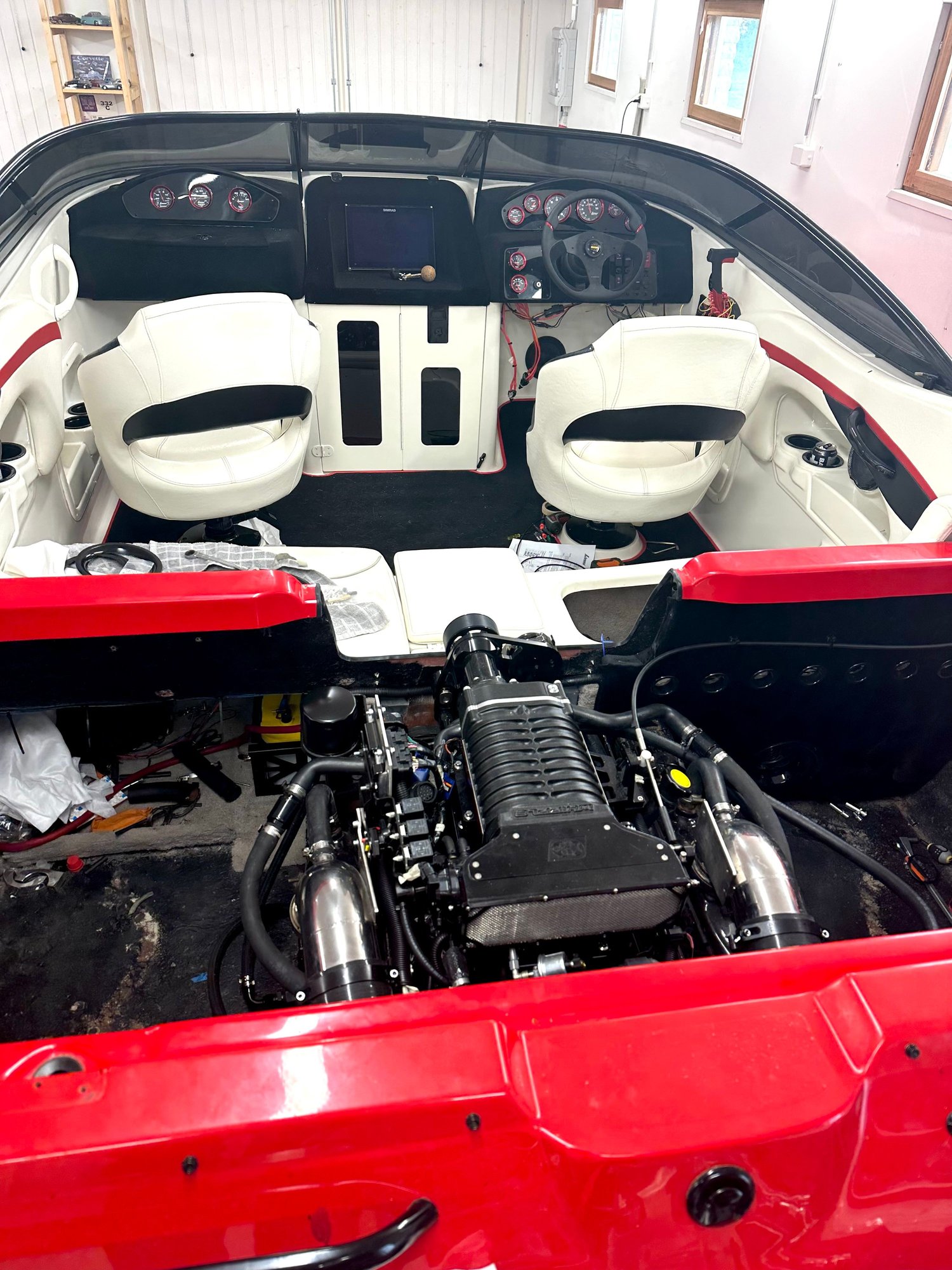

Mankka 07-09-2025 12:18 PM
https://cimg5.ibsrv.net/gimg/www.off...1d8f39a65.jpeg
One photo about my boat project.
