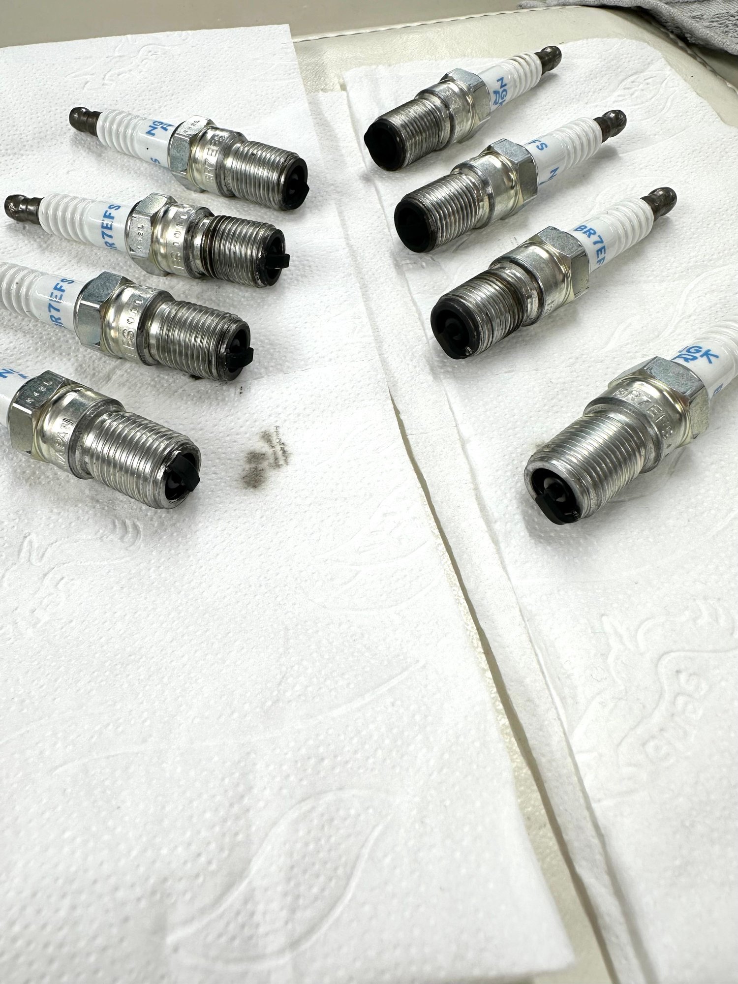

https://cimg1.ibsrv.net/gimg/www.off...b10091f83.jpeg
This is how wet spark plugs are in cylinders 1 and 2.
https://cimg2.ibsrv.net/gimg/www.off...35afd2de6.jpeg
Set of spark plugs after idling little while.

I use to run ngk #7 also but have went to the autolite 3923 and it has helped a lot with long idle time, if you have access to a set Id throw them in and see what happens, set the gap at .035
