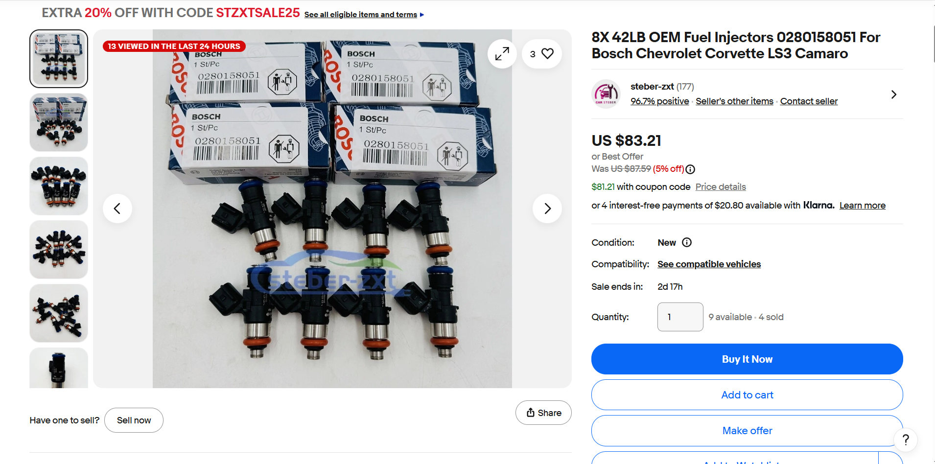

Is this right? Part number says it fits HP500EFI are they counterfeit? is there a better option?

Hopefully Smitty ( Articfriends ) on here will see this, he is the King of injectors........If you're buying injectors for 10 bucks a piece they are junk.

Thats what I was thinking. Who makes the oem mercury injectors?

If they are stock 500 efi injectors they are no longer made
Smitty may still have my old stock 500 efi injectors if you need some I replaced all mine when I did rebuilds this summer.

So I wastn't sure what was wrong when this first happened and was searching a lot of stuff including new injectors. So now almost 2 weeks later, all my feeds and emails and weather pages are full of injectors lol. these just popped up somewhere this morning, and I saw the 8X and thought that has to be a typo...
I will definitely send them off(hopefully to Smitty) this winter to have them checked/fixed.

To read on 500 FI injectors Artic friends did a lot of threads on this period even the 496 Guru guy that said he came up with a perfect matching side of 500 if I injectors, they fell short just because something is rated at the same flow at the same pressure as what they’re replacing does not actually mean may perform the same this a lot more than those two numbers.

to date there is no replacement injector thats a dead match, the 500 efi has tiny injctors flow wise for its power level at 36 lbs. The 42 lbs you found flow more at static and most likely less at lighter settings on top of fact they are chinese junk and wont flow real great overall at 10$ a piece retail, lmk if you need yours flowed and checked, Smitty
