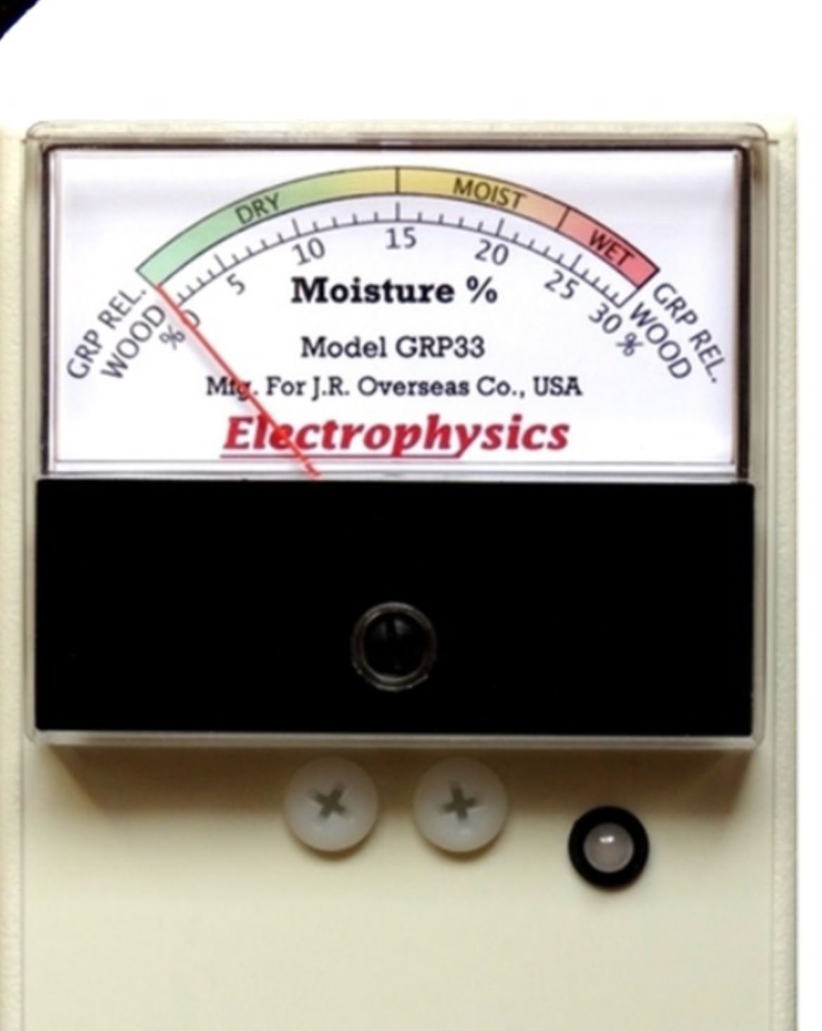

FWIW, I have the same ExTech meter that a lot of boat shops use and the only way to get an accurate reading is I have a piece of untreated 2X4 that has been on a shelf in my shop just for this. It has been "dry" for 15 year meaning it has never been in the weather or on concrete, sits free air on a rack. I calibrate "zero" my meter on that piece of wood before testing anything for moisture. Depending on the humidity, if I zero my meter to to atmospheric air, it will vary from 9-13% and it is super dry. Now, after zeroing my meter at the time of use to that dry wood, anything above that I deem as added moisture. Now a wet boat doesn't mean a rotted boat. My Sunsation was reading 34% when I did the transom and it was rock solid but wet wood. I coulda rocked it for years and likely did prior to that before noticing signs that it was wet. Not sure if this helps but something to think about.

^^^Very good point. Coming from a calibration business for 37 +years, it makes perfect sense to set a zero reference prior to using any meter to measure almost anything. The expensive meters, both electrical and mechanical, if miss handled can lose their reference point. Reputable surveyors will use expensive, accurate meters, but they likely need to be calibrated and re-calibrated on a specific schedule.

you are correct, but they do take that into account. That's why they are not looking for a reading of zero. They are looking for a reading of 20% and above as they consider 20% and below to be dry, and my statement is in regards of using the correct meter a marine meter not the junk you buy at the home centers those are garbage
