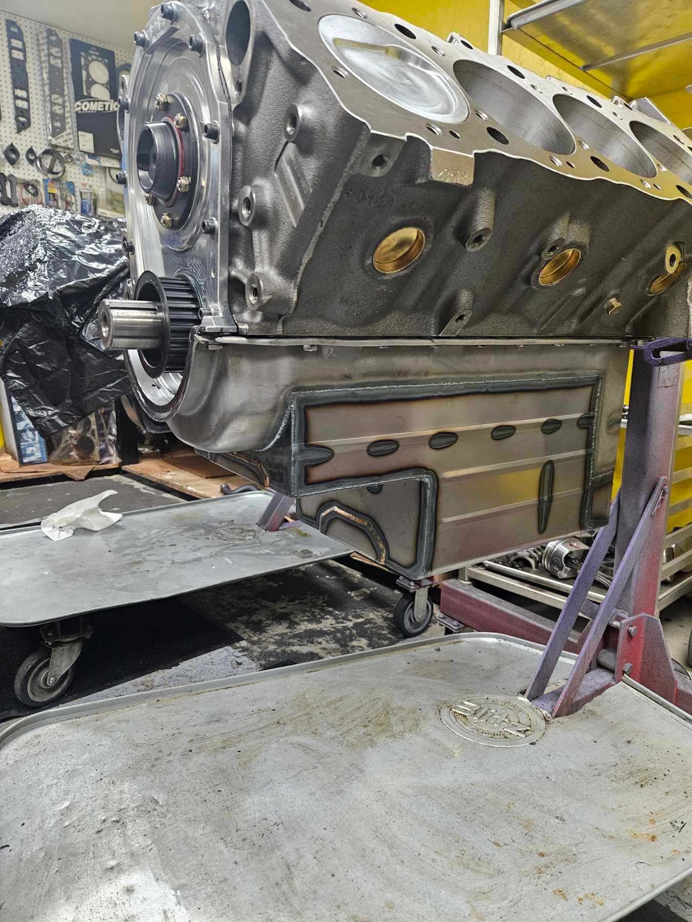

ICDEDPPL 10-08-2025 04:41 PM
The oil pan is such an important part that gets overlooked.
I`ve always had pressure issues due to aeration, even with the best marine pans I could find.
Got tired of losing pressure on almost every engine and went external oil pump for that reason.
Got better but not great.
Eddie has custom oil pans built just for this reason to his specs.
These are the first engines I`ve had where both oil pressures are solid as a rock no matter the RMP or how long I run the boat.
Whatever he`s doing is working perfectly. No fancy oil pumps either ..
Whatever you do don`t skimp on oil pans. I don`t know what to tell you to get because I thought I was getting a good pan (canton marine) and still had aeration problems. The longer I ran the boat the lower the pressure got.
Eddies:
