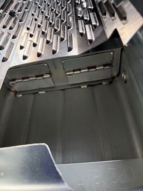

Also I'll attach a couple pics....these are the little flip up "doors" in the bottom of the pan. There are 3 oil baffles with 2 of these doors in each...should I leave them or remove one in each or remove them all together? I assume these are for racing applications where braking will cause oil to run forward and creep up the front of the pan?
Thanks for the help and suggestions....I'm sure I'm diving way too deep into an oil pan but I'm kinda a nerd like that and like getting my head wrapped around things.
