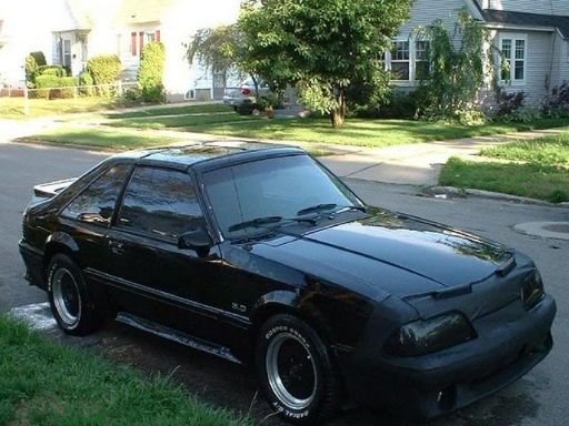

Aluminum -6AN fuel rails, Seimens Deka 42lb injectors, currently going to fire it off stock pump, but will be installing Aeromotive 340 this winter.
Not an all out build, just for putting around. I haven't had the car on the road since 2003. 1987 T-Top car.
I just pulled the K-member and welded new boxes, new Strange +10 adj, struts
Stock block
DSS +0.030" pistons
Ported Promaxx 180 heads
9.8:1
Comp XE 274 cam
Holley EFI
