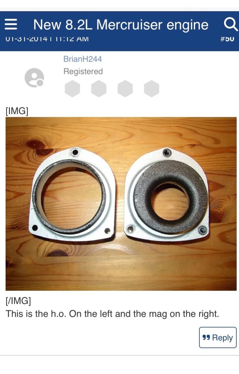

I've been investigating this question for the last month or so . It seems like all the 430hp HO engines have Cats and DTS Electronic throttle body . I have yet to see a mechanical throttle body - non EC ( no cats) HO version . I think they did make it but I haven't seen one , which makes finding a used ECM tough.

The only reason I think a mechanical throttle body HO engine exists is because of this picture and info I found here on OSO .
