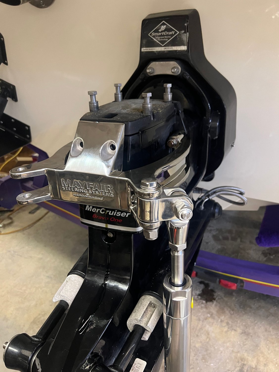

Without seeing the bracket that you are mounting there I would say it is usually not a good idea to use a washer under a bracket. It keeps it from sitting flat on the surface and might compromise the long term strength.
First thing i would do is call whoever made your conversion kit and ask them. If they say its ok to space it out then go for it.
Otherwise I would personally do away with that grounding point and and use an alternative or put it on the other side of the bracket and drill a hole and use a longer bolt like Mbam suggested.

Bill,
Kinda too late. I’ve already machined the bracket. It’s all good, though. Everything lines up perfectly. Moving forward.
Thanks. Brad.
