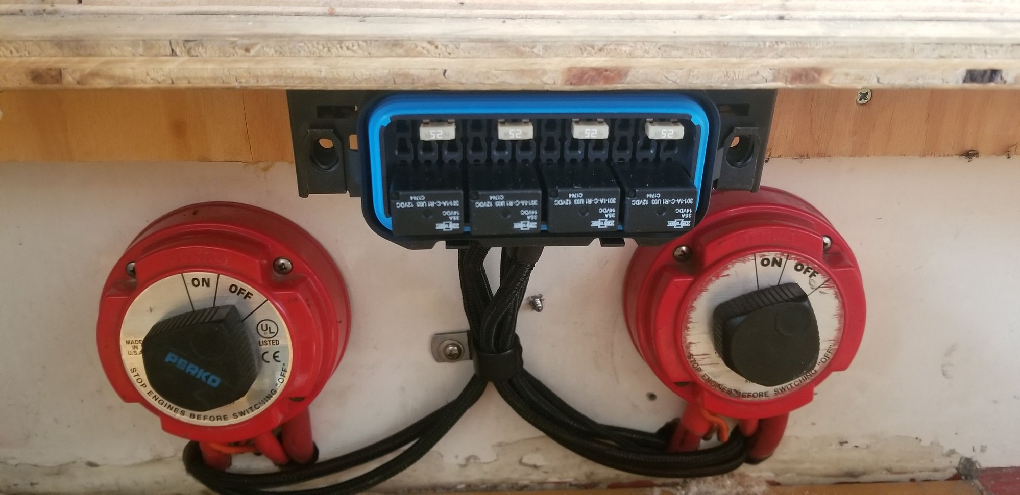

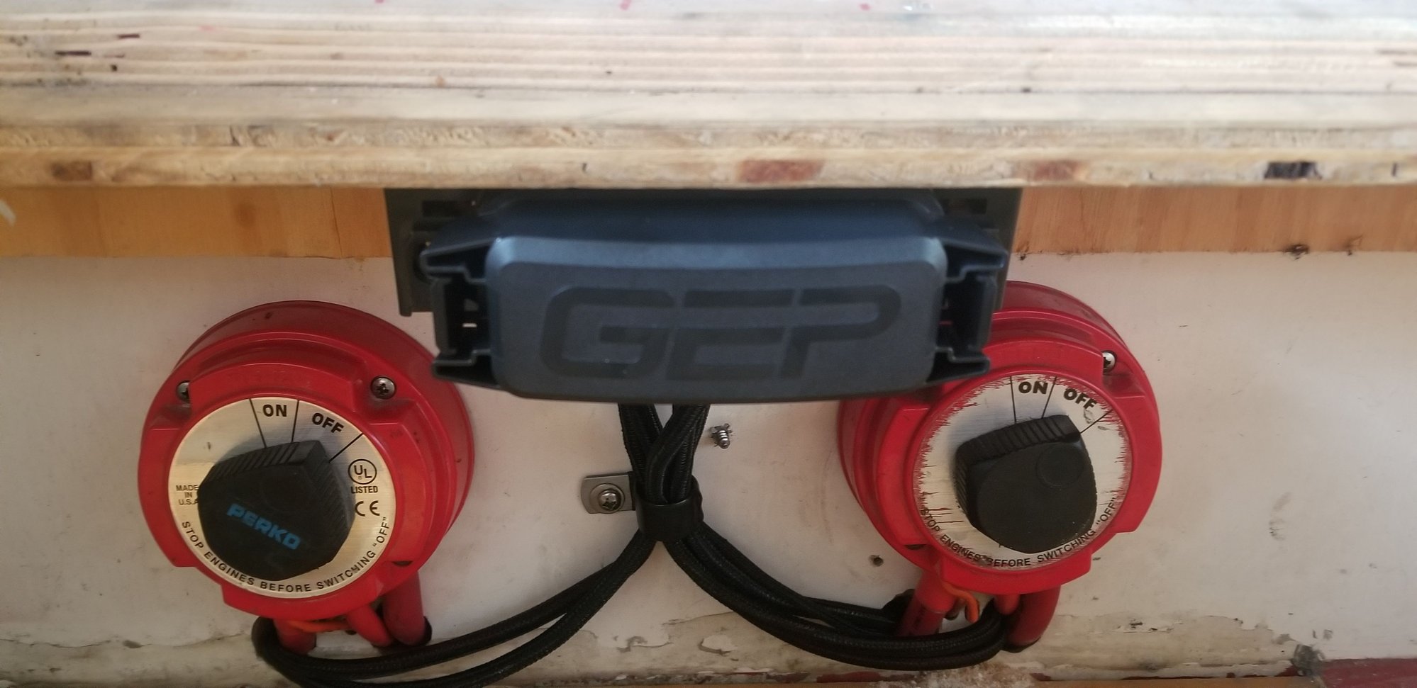

I had a custom built relay to handle the 2 stages, not sure if that was needed but it worked well.

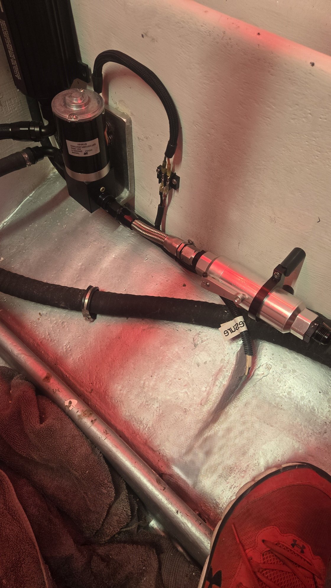

I have 2 weldons and they are much quiter than the A1000`s they replaced . Eddie really likes Weldon. He`s not a fan of the Aeromotives. I repurposed the A1000 to transfer fuel from one tank to the other so that I only have to fill on one side.
I have them mounted to the stringer.

relays for twins:
https://cimg0.ibsrv.net/gimg/www.off...33d6c2bea3.jpg
https://cimg1.ibsrv.net/gimg/www.off...801490c3be.jpg

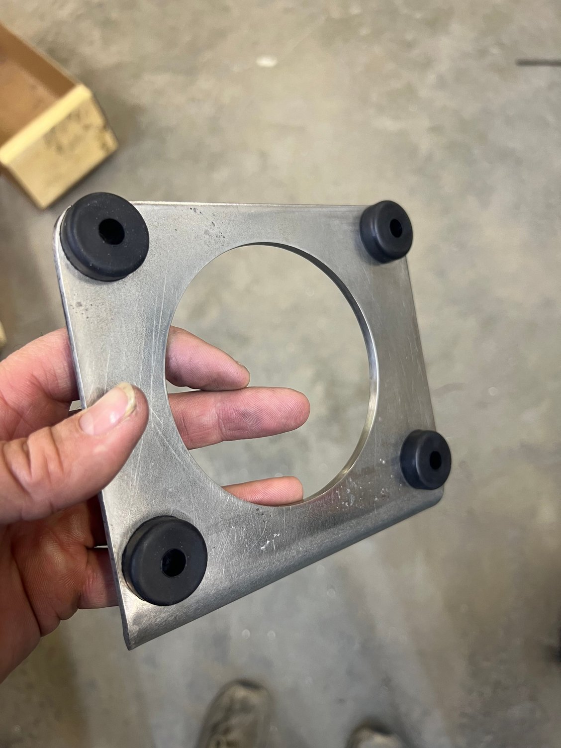

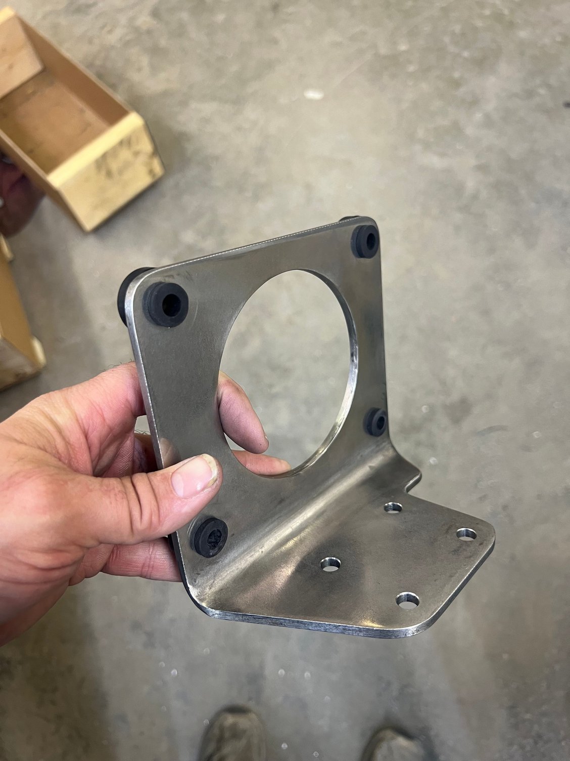

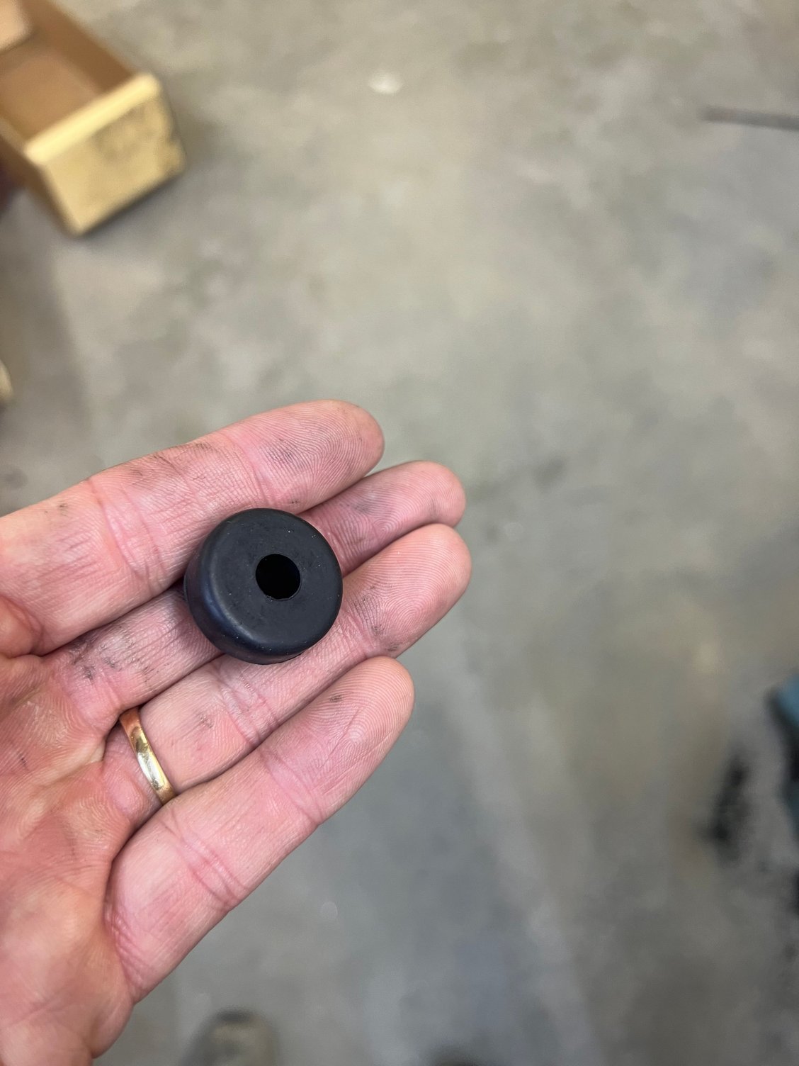

Brad Christy 12-23-2025 08:43 AM
Guys,

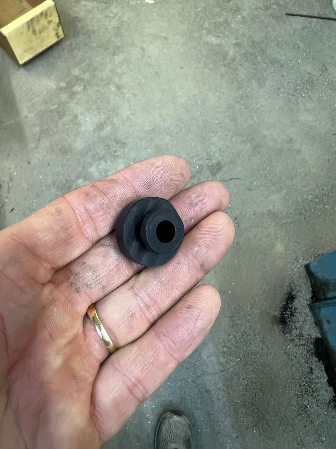

Sometimes things just come together. I found the absolute perfect grommet. At Lowe’s, of all places.
https://cimg9.ibsrv.net/gimg/www.off...7c78562ed.jpeg
https://cimg0.ibsrv.net/gimg/www.off...71738ce59.jpeg
https://cimg1.ibsrv.net/gimg/www.off...9780fd439.jpeg
https://cimg2.ibsrv.net/gimg/www.off...6aec30b6b.jpeg
They are an absolute PITA to get in there, but they fit perfectly. The hole is even the correct size.
I’m planning on installing rubber washers between the pump and mount and between the screw heads and the mount, with a bit of blue LocTite.
I spoke with Weldon this morning. They are out until after the first of the year, but they do rework them, so that will be in the works, as well. Should be whispering quiet when it’s all said and done.

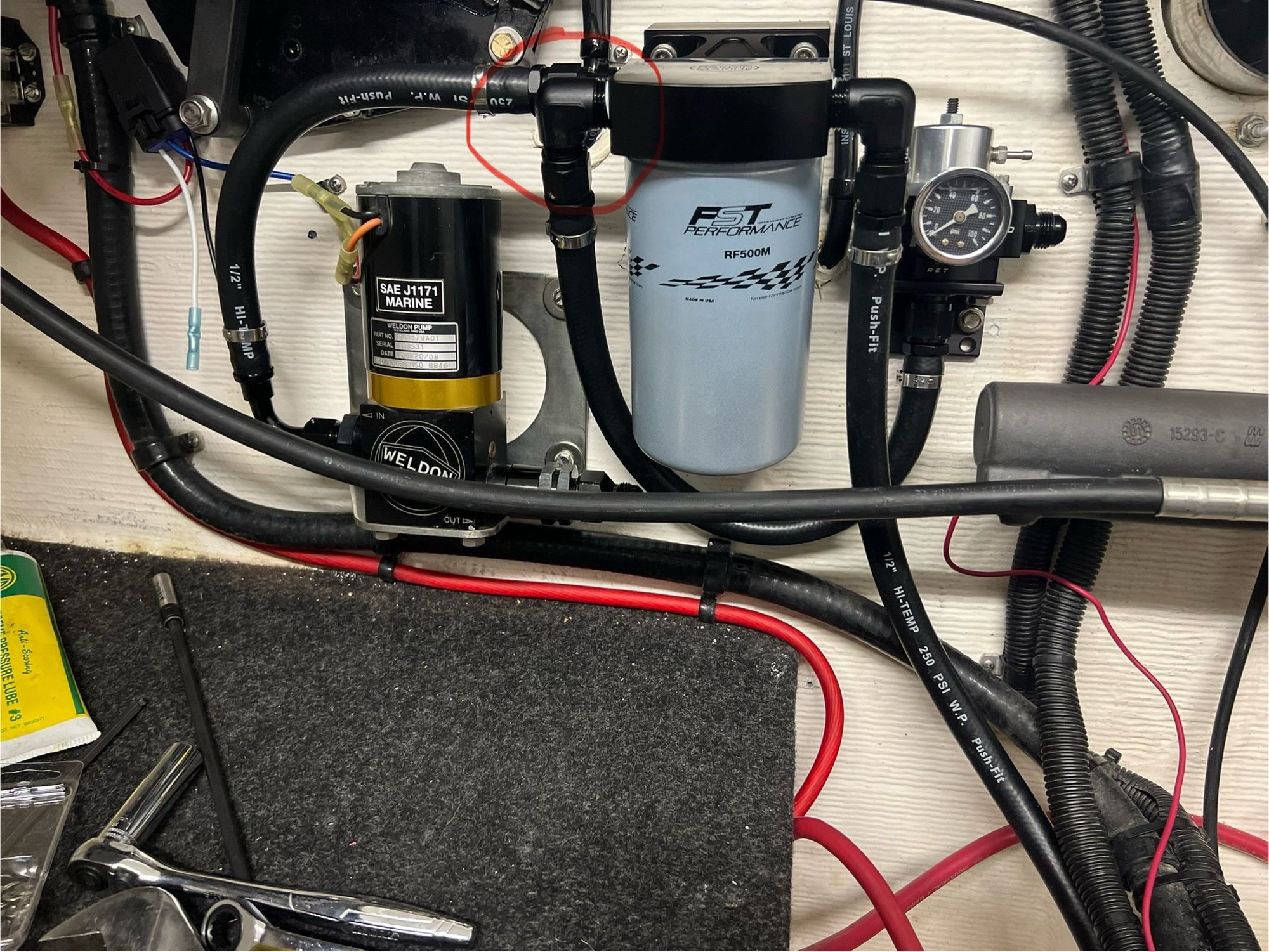

Brad Christy 12-23-2025 08:48 AM
Originally Posted by Helmwurst (Post 4940455)
Big thing I was told was to not run those sharp bend fittings and be sure to use full flow fittings. They will aerate and overheat the pump.
Helmwurst,
https://cimg5.ibsrv.net/gimg/www.off...5e5f17985.jpeg
I don’t have any before the pump, nor immediately after, but there are some at the filter head. Didn’t really have a choice there.
Thanks. Brad.
