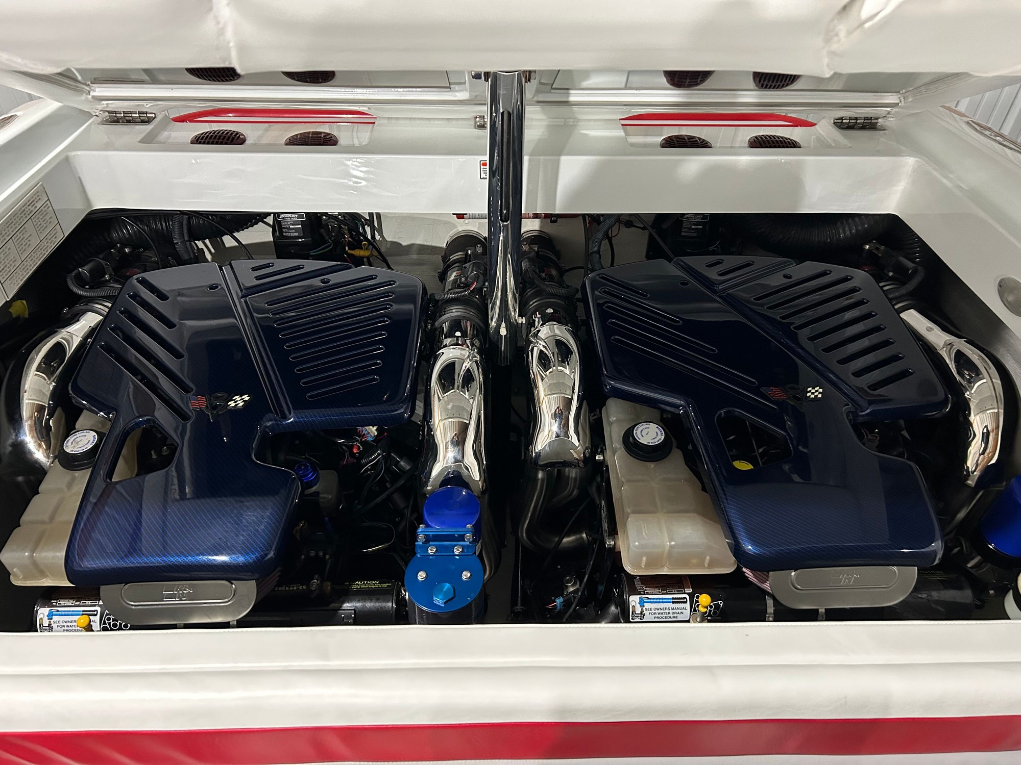

either way the engine room looks freaking amazing
