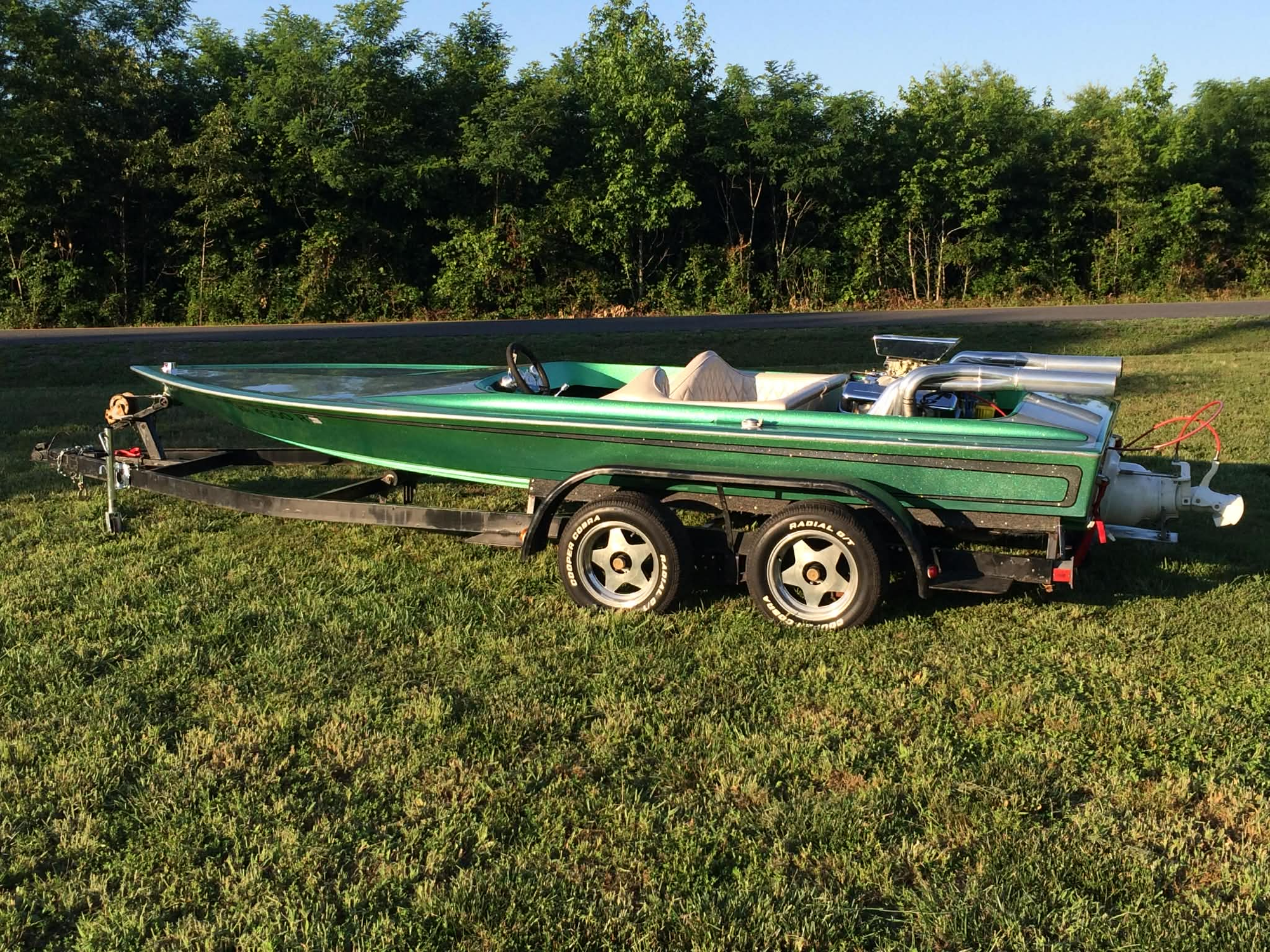

This thread and post reminded me of when I bought this jet boat with a 468 years back. When I brought it home I noticed it had a PAPER air filter/cleaner on it! Could there BE a worse option to put on a boat?! :D :D
Backfire: blow up boat
Splash air filter: blow up motor
https://cimg0.ibsrv.net/gimg/www.off...d2a2a174e4.png

Dave,
Ah, yes. The old garden hose. I remember dad blowing these off the water in our blower motor V-drive without even getting into the secondaries. Good times. :cool:
