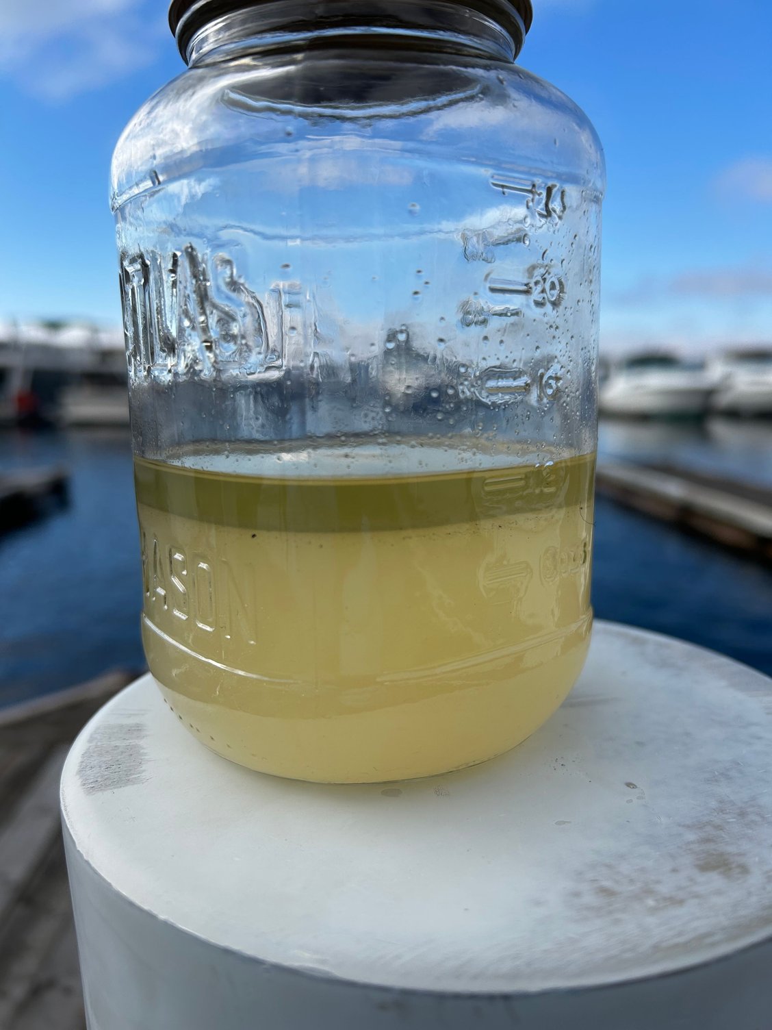

Was it bad gas from the marina or phase separation in the slip…I don’t know.

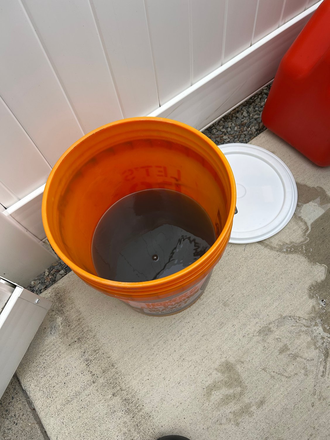

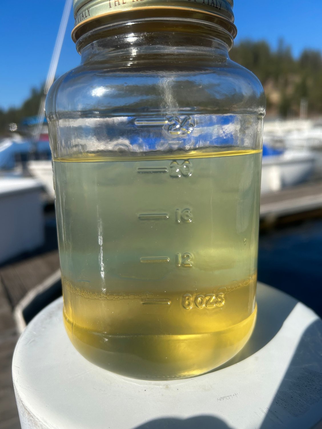

My 1992 Cobalt 243 died on the lake at the end of last season with either water in the fuel tank or phase separation. I tuned it up and changed the oil in the slip, pulled the boat home where I pumped/siphoned out the approximately 35 gallons of bad fuel and finally refueled with 88 gallons of 91 non-ethanol fuel. The fill in late July was the only time in 10 years when I’ve used ethanol laced fuel from our marina gas dock. What should I be focused on prior to launch next week?

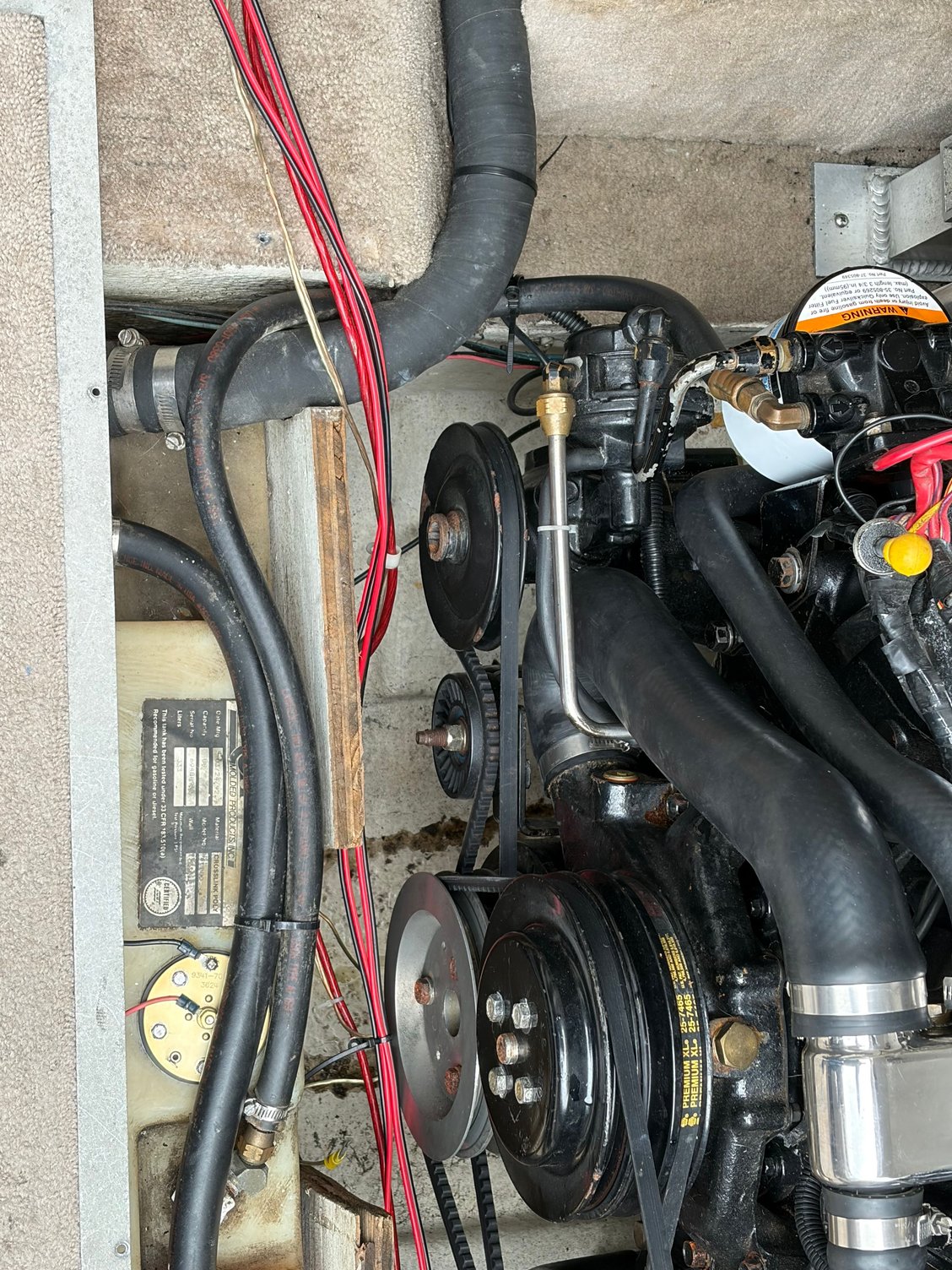

I’m picking up the boat today from storage so I can get started on this additional work. I’m thinking at minimum change out the fuel line to the new A1-15 rated hose (should the fill and vent hoses need changing ?). I may change the oil and plugs again as well as having a couple more fuel filter swaps. I did use StarTron tank cleaner in a 5 gallon slosh drive on the trailer last fall prior to the final drain and final fill up. This boat will never see ethanol again. The is a stock 502 BBC with an Edelbrock 1410 750 cfm carb and RPM Air Gap intake manifold. Here’s some pics:

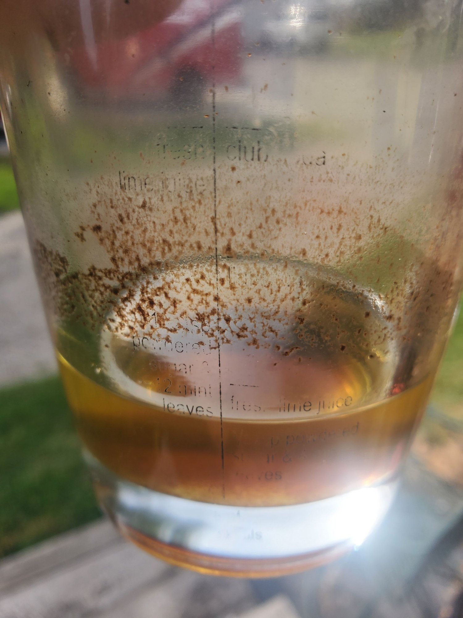

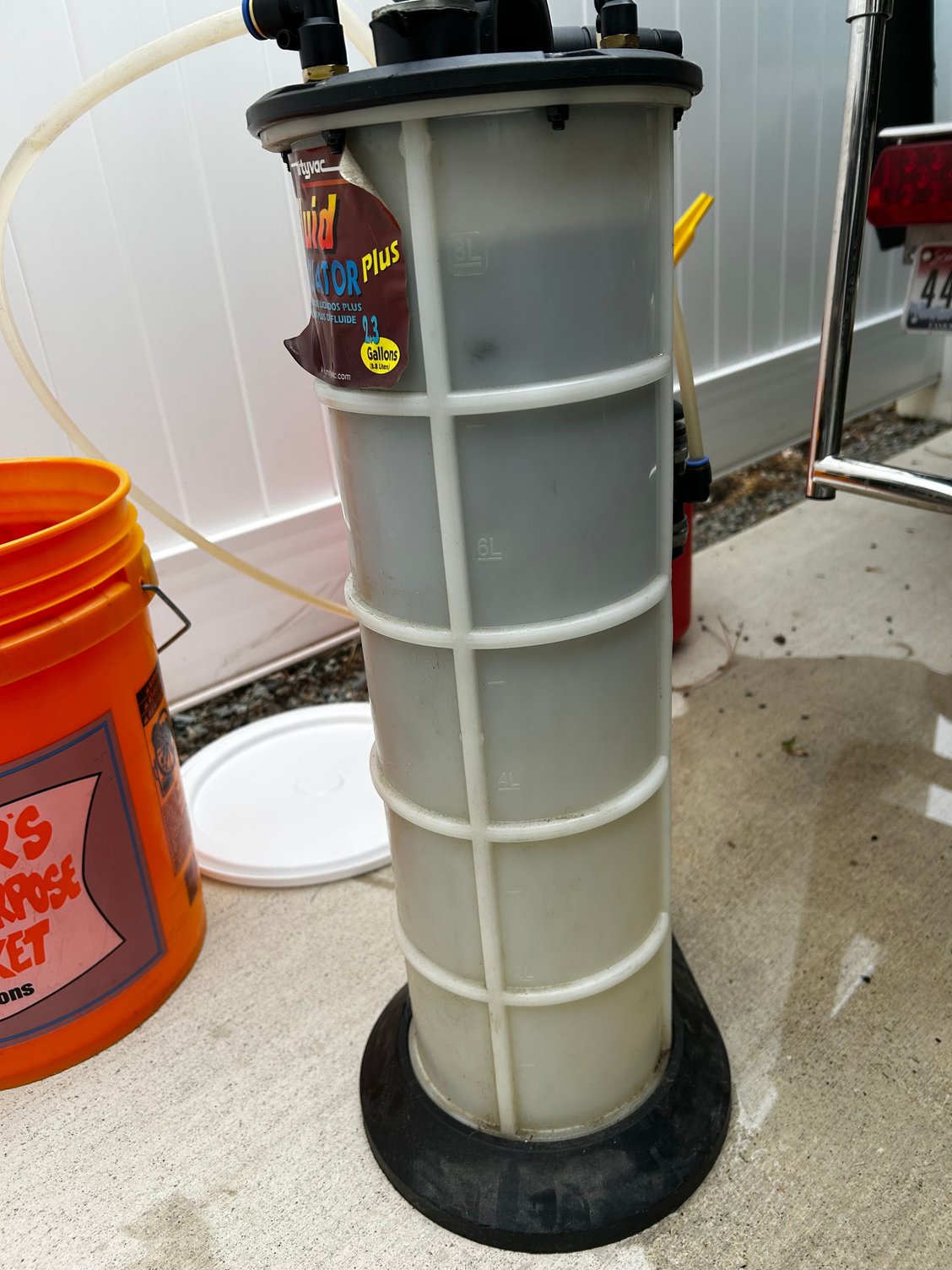

Some additional crap came up with the fuel…I now know this is not the way to remove fuel.  I siphoned the rest.
Some additional blob of crap came up with the fuel…I now know this is not the way to remove fuel. I siphoned the rest.

That appears to be a lot of water. I would confirm that it was in fact related to the gas you got and not water entering into your tank from somewhere like the fuel vent.

That’s a good point. I remember being anchored for a few hours watching the Chicago Air and Water Show in a 26 foot cat. After the show the boat started, died and wouldn’t restart. It was a wavy Lake Michigan afternoon and I later figured out that water was dumping in the air vents on both sides of the hull for hours. The waves would wash over the vents. Needless to say I pumped all the fuel out of the tanks at home and I couldn’t believe how much water got in the tanks.

Talked to the marina manager in October regarding the fuel purchase on July 30, they didn’t fess up to any bad gas…needless to say I will pull the boat out and fill with non-ethanol fuel at a cheaper price. I’ll be extra diligent about treating the fuel, etc.

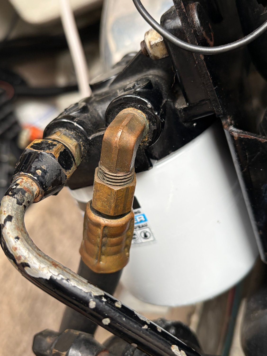

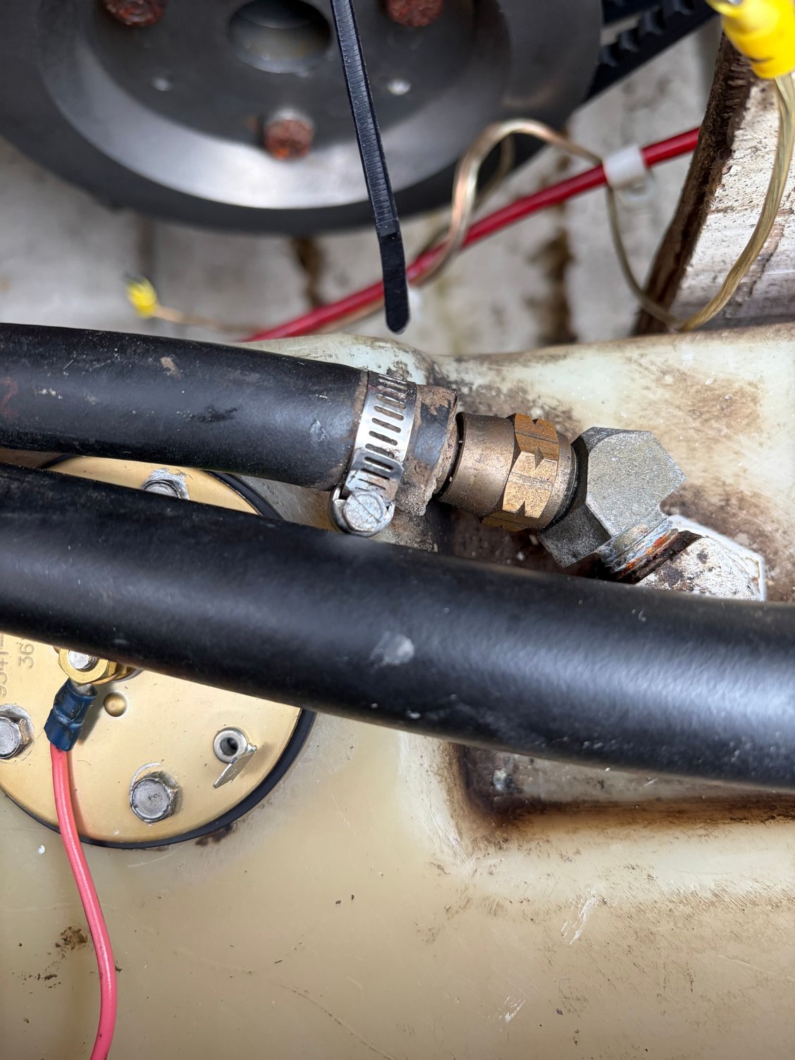

Regarding the 1992 dated hoses…3/8” A1 rated tank to fuel pump maybe 26” long with the pressed crimp fitting at the fuel filter and barb clamped at the tank…is this one critical to replace? And if replaced I’m assuming the crimp connection at the pump is critical for flow? And the 1992 5/8” vent hose should that also be replaced due to age? The 1-1/2” fill hose?
The oil and plugs only have maybe an hour run time while I was swapping out water separating fuel filters in the slip…re-do all that advisable?

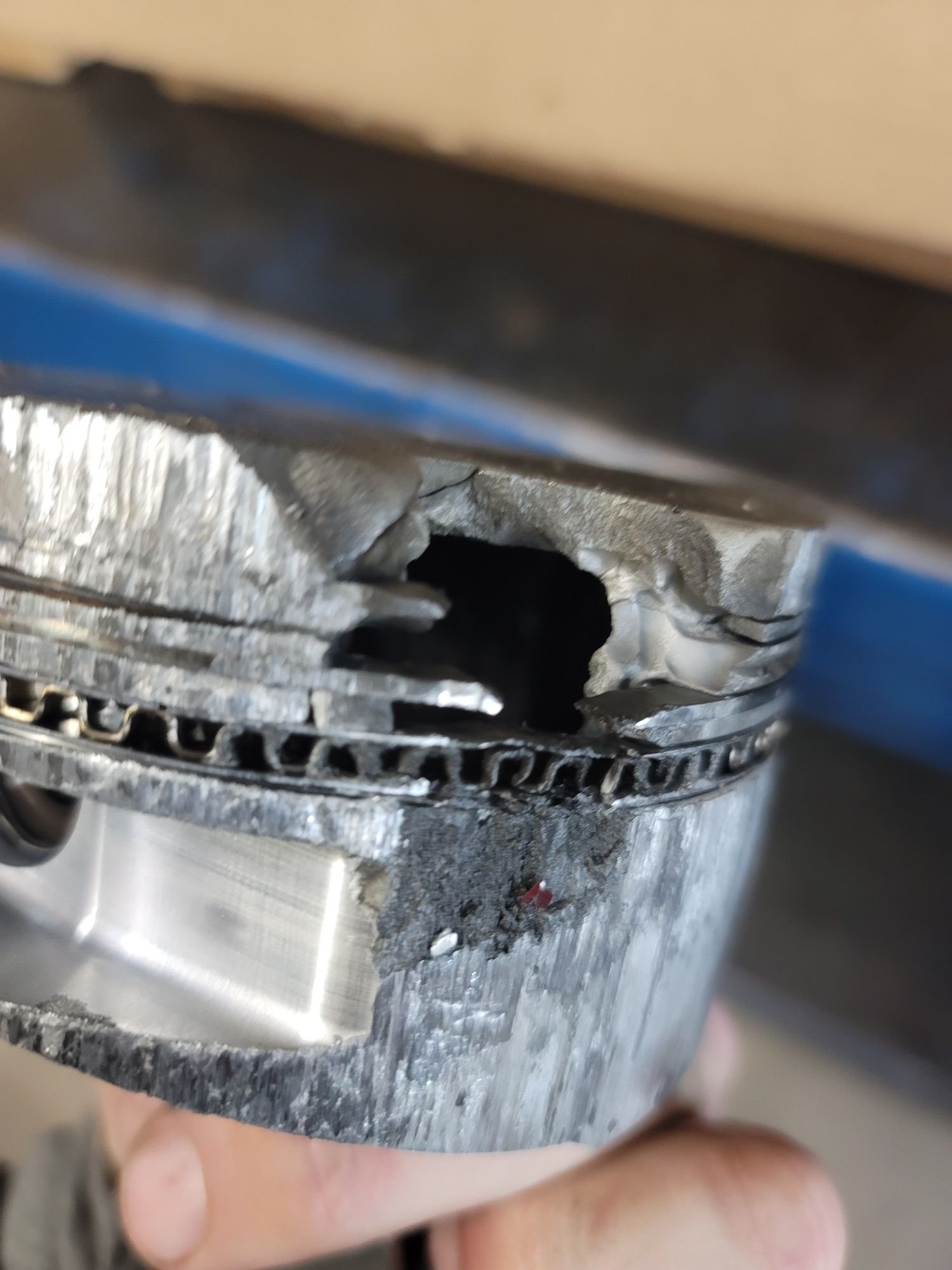

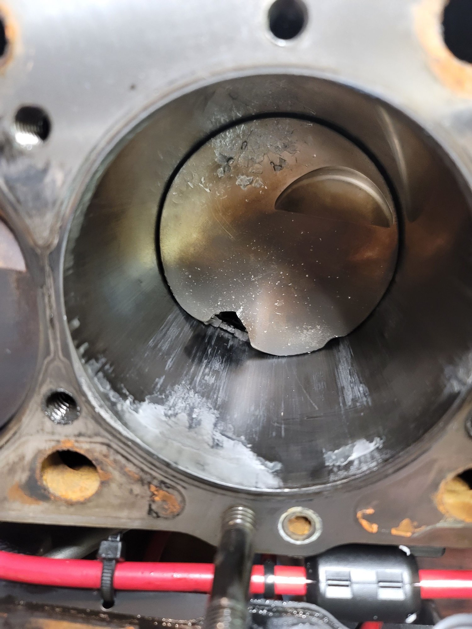

You`re lucky you didn`t blow an engine or 2. I did fter getting some terrible gas.. I prefer ethanol, keep the AIT down , as long as you go thru it in a few weeks it`s not an issue.
You got bad gas or water in your gas from an external source, that`s not phase seperation. That takes a long time.I did some testing on that .
