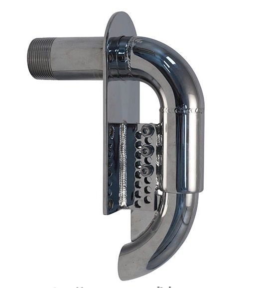

How about inserting a Y inline between the transom pipe and power steering cooler (first thing the intake water cools) and adding the pickup line there? Would I still need a pressure relief line?
My thought is that would still allow flow through outdrive, and potentially reverse flow as a pressure relief if pickup provides too much pressure.

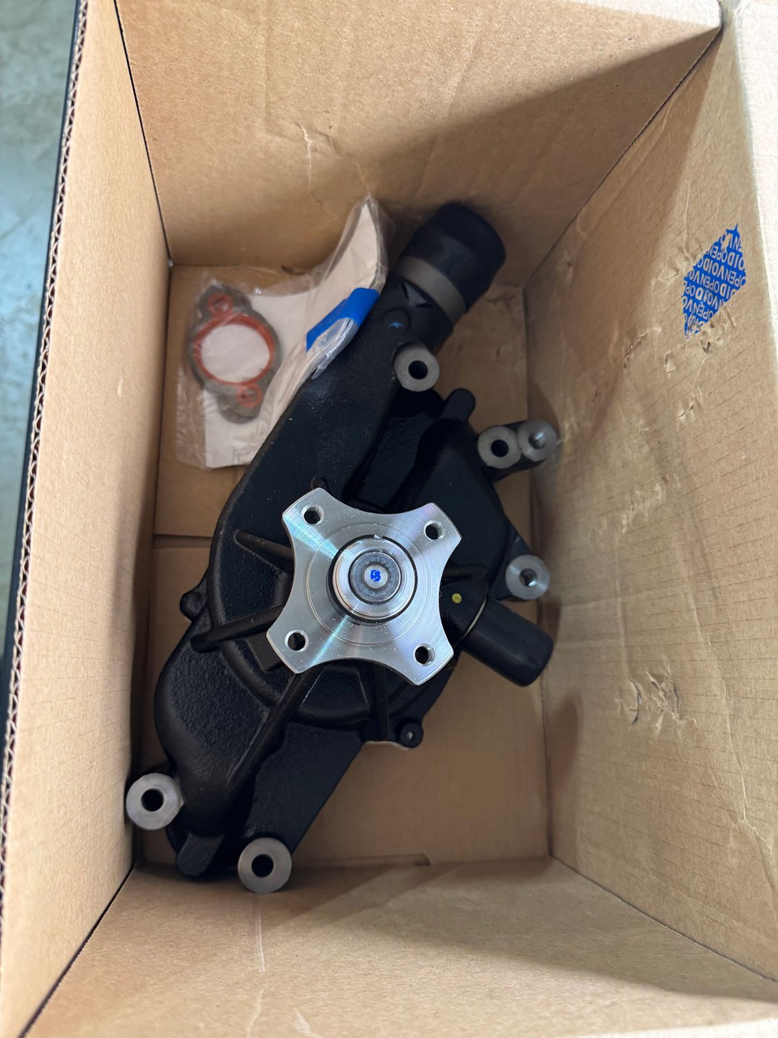

ChickenSteve 04-17-2026 09:34 AM
Got one!
