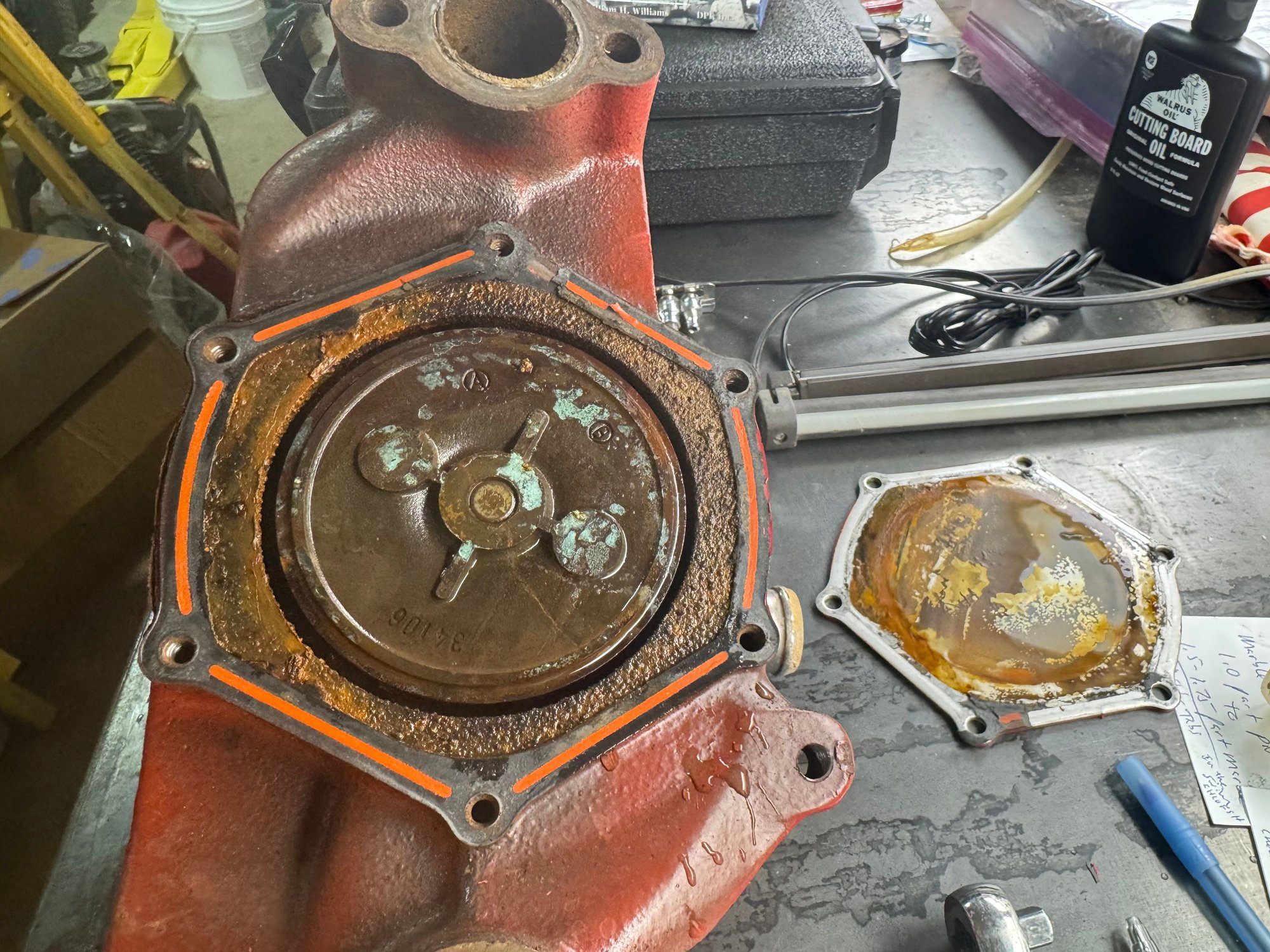

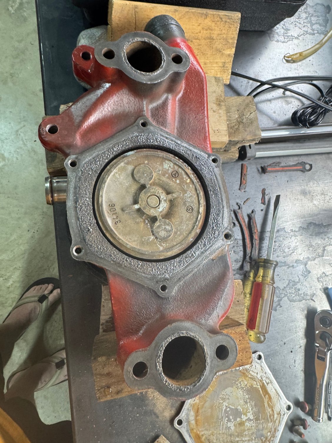

after reading through you original thread with your over heating issue it sound like you replaced everything except your circulating water pump on the front of the motor you do mention that you took it off and apart and every thing looked good. I also had a similar over heating issue and went through pretty much the same process i also took my circulating pump apart and found impeller in good shape and tight on the shaft but since i already had it apart i went ahead and replaced the circulating pump and low and behold it solved my problem i can only think that under load it must be enough to allow the impeller to slip on shaft you might try replace circulation pump first before jumping through any more hoops, i know what your going through chasing a over heating issue drives you crazy good luck.

I guess there’s a chance it’s slipping. I should have scribed a line on shaft and impeller as a reference. Sure don’t see any signs of slipping. What’s another couple hundred at this point. Here’s a before and after cleaning. I had a 19 second video but it was “missing a security token”.
I am sort of in same boat
I have taken everything apart,
1988 pump re-circulation that is this has Vanes and is solid
the new pump vanes are about 1/4 longer and coated with what looks like some hard coating
Boat is only freshwater
112 is not bad for a sierra pump
New pair arrived late yesterday..amazon🤣

1/4” longer vanes should make a big difference.
