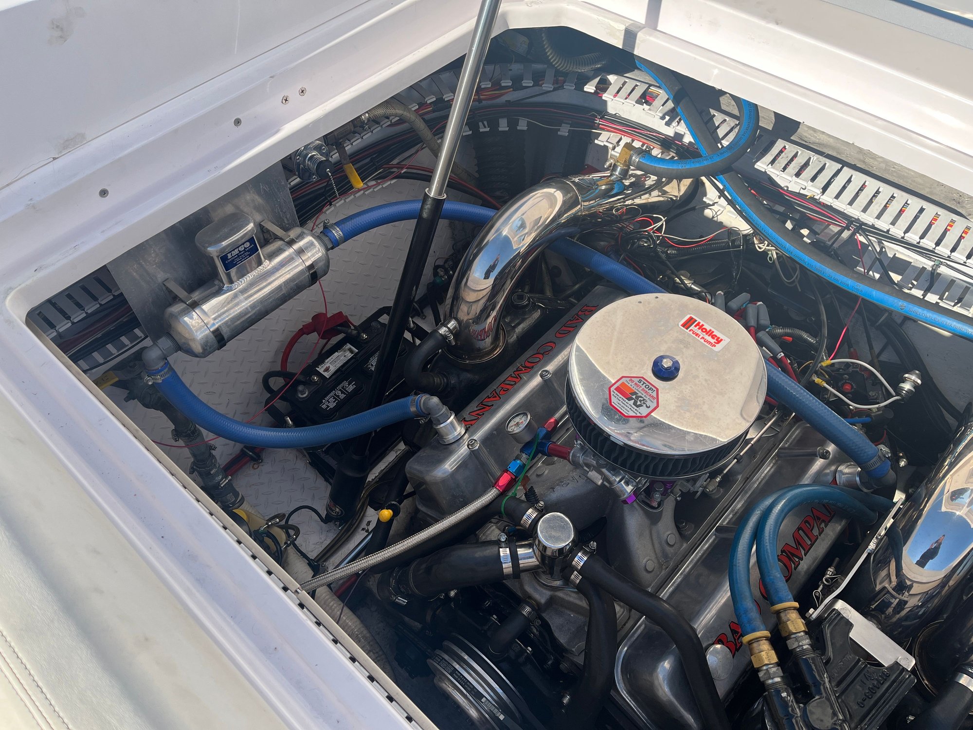

This is what it looks like. Maybe a 8-10" rise. Also the water exits the side of the boat through the black/blue hose. I would need to change this setup for silent choice though. thoughts?

So, your current exhaust is dry ? Ie: no water comes out the tailpipes ?
thats what it looks like. Im not very familar with these tails. ive always has the wet ones. i just got the boat last fall and only drove it twice before having to pull the engines from excessive blow by. i have very little seat time in it. i didnt like how loud it was without captins call as an option. Theres a time and place for it. maybe im just getting old LOL
