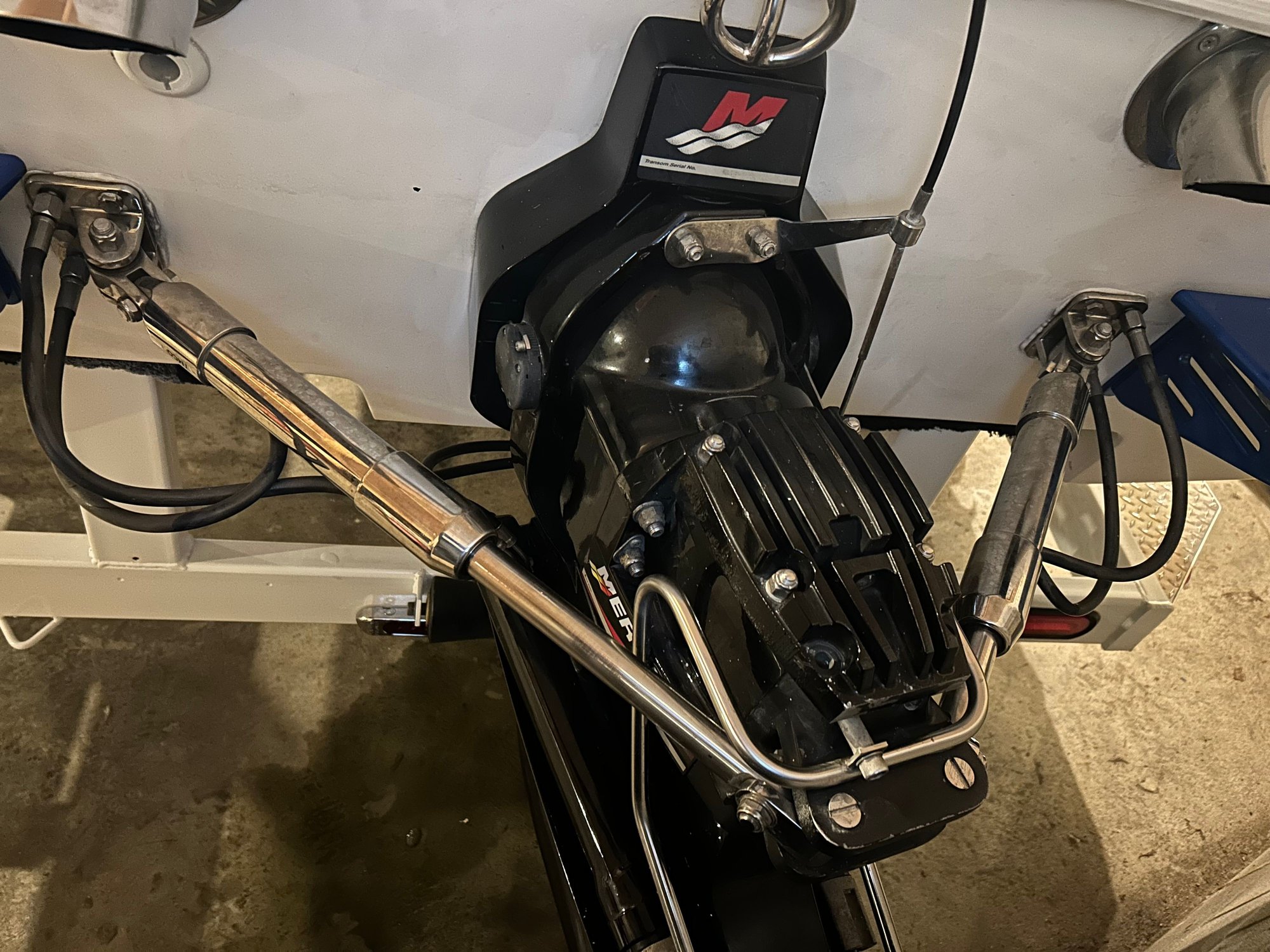

First time taking my 26’ Firehawk cat out today. It has dual IMCO hydraulic steering and no reservoir tank.
Very hard to steer when idling. Then later I could tell it had air in the system.
I’m guessing it should have a reservoir tank or is it possible for it to work correctly without one?
I’m familiar with my previous Fountains Latham steering. They had tanks and were self bleeding.

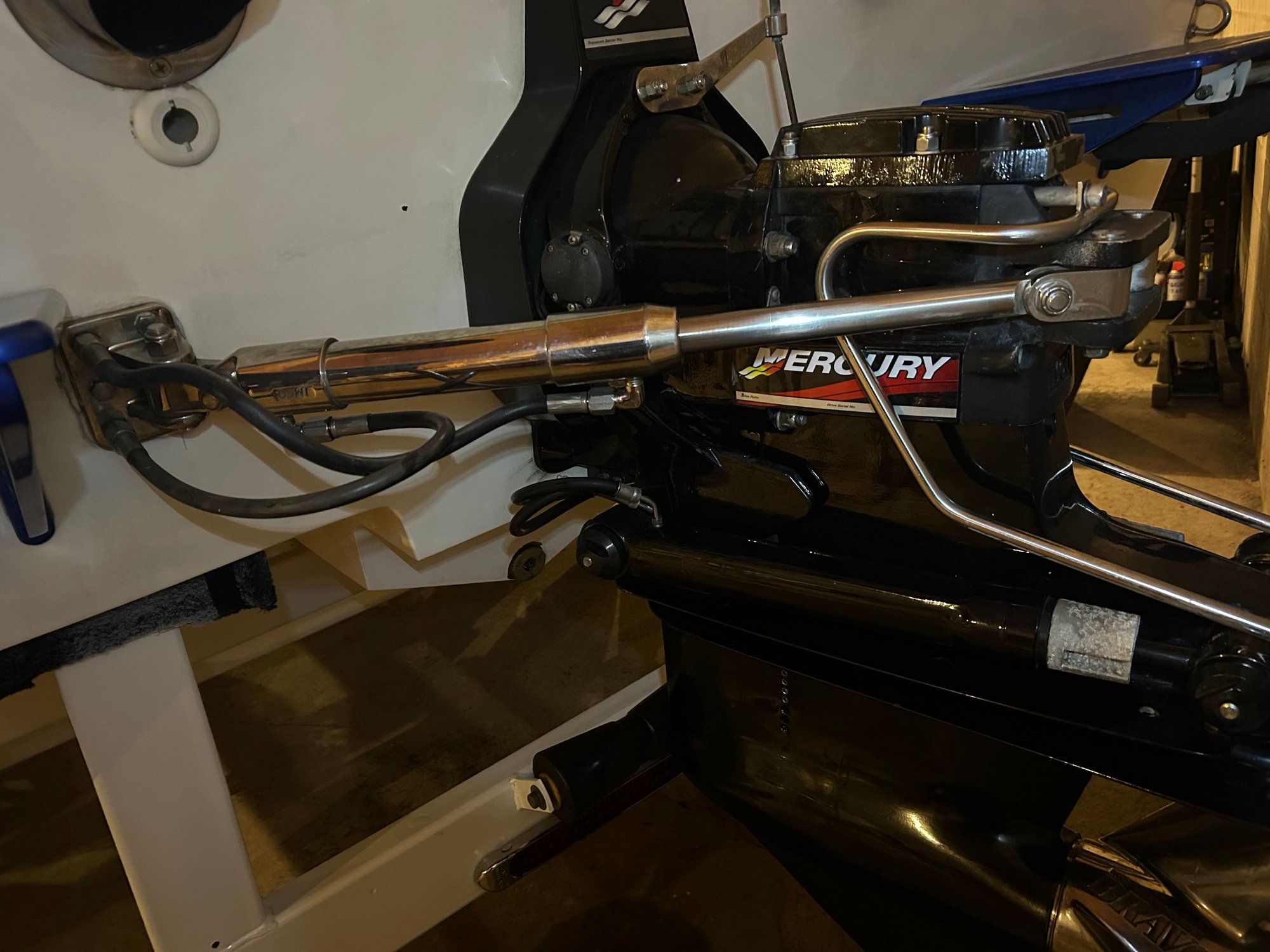

When I got home i tried turning the wheel one way and it pushed air/fluid out the pump cap. Drive did not move.
Got out of the boat and moved the drive back and forth and I could feel air in the rams.
Just trying to figure out where to start. Should I crack a ram line and turn the wheel to one side? Can I get it to work without a reservoir?

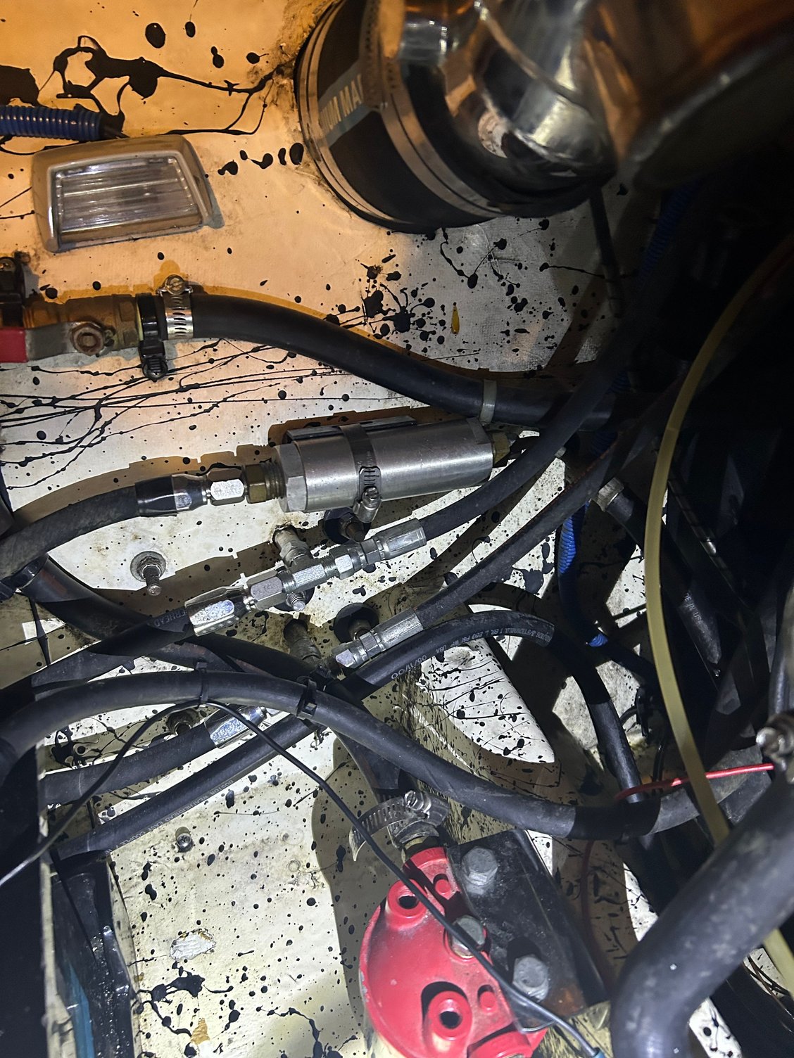

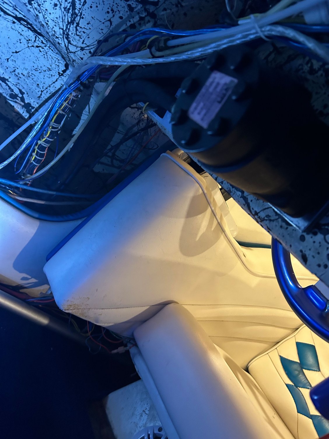

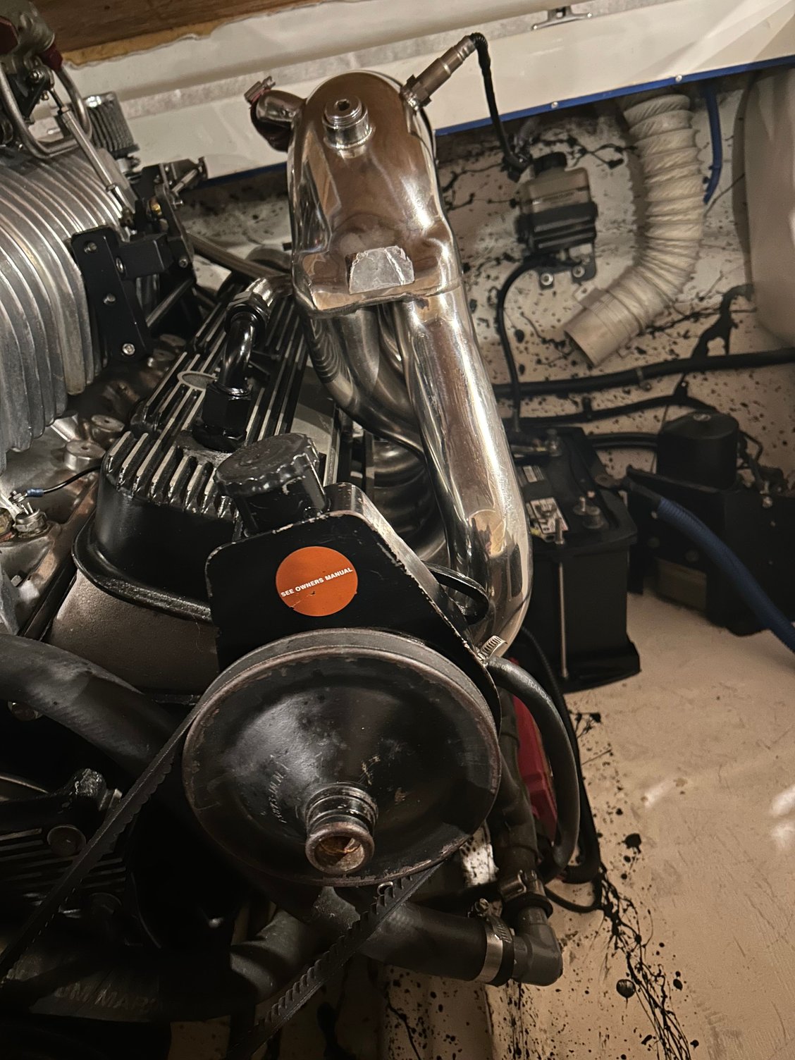

I have run 2 full Imco systems without the tank and it will work fine, you just have to keep the reservoir filled as you bleed the system. Your system needs to be bled. There are multiple good threads on here on how to do it. It is a major PIA and a 2 person job. If it is an old system get a new filter. Post some pictures:

That’s good to hear. Answers my main question. I found it odd that it didn’t have one but also thought it had to work because it’s been like that. Not sure if the boat came with the hydraulic steering or was added on at some point. The boat sat 10 years with the drive up. Drive would not go down because air was in the rams. Guess the same thing happened to the steering rams.
Anyways, yesterday I got some air out by pushing the drive to each side and opening a line. Now it will steer without running.
I found bleeding instructions. I’ll get someone to help me with weekend. Thanks again. I’ll give an update next time I run it.
