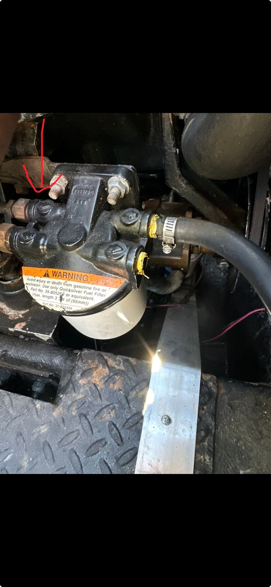

See red arrow

Originally Posted by deathdealer
See red arrow
DD,
Back to the filter head. Got it. So reroute that line so that it doesn’t get hot, and we should be good?
He has the pump kit on order, BTW….
Thanks. Brad.
Brad Christy is offline

Yes, if the boat has a return line from tank you would route red arrow to tank. And plug the filter housing.
I approached it as my options were add the second pump kit or reroute to tank. If I didn’t have access to the kit pump so cheap I would have tried a tank reroute as the tank effectively is a gigantic fuel cooler. Dead head to the filter housing in a hot bilge was certainly part of it. I didn’t want to change too much at once to isolate my issue so I’m still running back to filter head with the pusher pump.

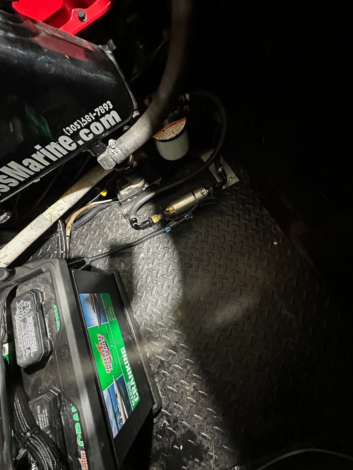

deathdealer is offline
