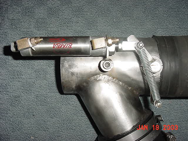

I dont know what to do to help your system, but I have heard it a lot. When I built mine, I used Bimba double acting cylinders ($25), a manual air switch and a $14 compressor from Farm Fleet (mounted under helm). I also used an over center spring set up so you only have to run the compressor to position the diverter, the spring holds it there, not air pressure. Just an idea.

another view

Nice set up! You made the entire system?

yea, winter project in 1990, total around $100. many hrs making the oval drop leg pipe and cutting the oval hole. Still in use.
