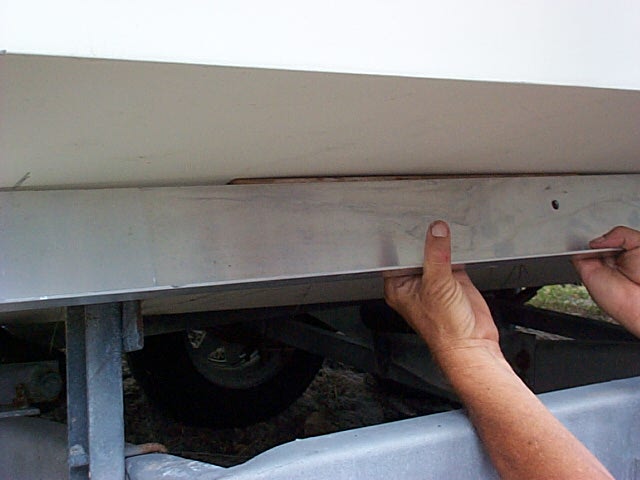

If the hook is right at the transom, is that just built up fiberglass that can be sanded off?

be careful with taking out a hook. one like that might be there from the factory for a reason. I would make sure you check with the factory befor removing anything from the hull. you dont want to make a big mistake .

see HBs comment.
Check w/ the porters' tech guys.
Without seeing the straightness "trend" from about 8' forward of the transom back to it, it is hard to tell what part is "curved" and what part has a "kickdown" to it.
Even if you opt to keep the kickdown (if that's truly what it is) then you can still benefit from sharpening the back edges of the strakes and transom.
I have a long castiron straightedge that is 2" wide on the base and weighs 80 or 90 pounds. I use 3M self stick sandpaper on it and it does a wonderful job. I cannot IMAGINE using this bastage upside down from the underside.
I've never done a sterndrive boat hull. Only outboard raceboats. they weren't very hard to flip over. Don't know what the best answer would be for a big 35'er.
Maybe you could get bunch of kids to sand on it from the bottom if you feed them lots of those Tony's Pizza Rolls (it works for that kid in the commercial for his yardwork).
