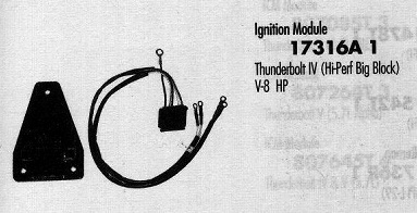

the pn#17316A1 sounds like a winner. Now does anybody know off hand if thats the "riser mount" type or is it on the dstributor?

Old 06-27-2003 | 10:14 AM
HiPerf2000's Avatar
Posts: 4,082
From: N.E.
Cal,
i did a search for you and this is the picture that is related to that part number. i found it at: http://www.lowerunits.com/precisionparts/263.html

mopower's Avatar
Toxic FORMULA
Joined: May 2002
Posts: 4,238
From: pitman nj
Mark,
thanks, that looks like what I'm after
