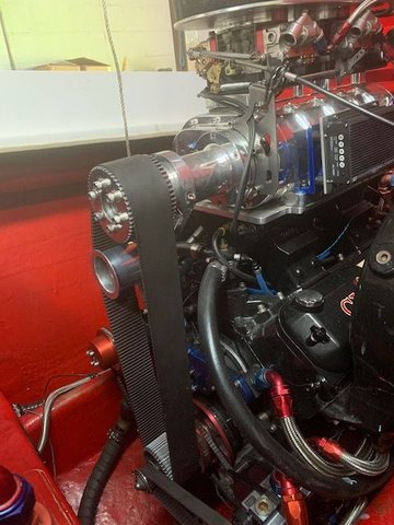

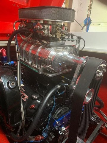

Been running 8-71's and 10-71's on Darts for 10 years or so. Motors seem to really like the port flow above 3800. You pick up a cooling effect from surface area of aluminum in TR. They do very well mid range and up on a dyno compared to a typical blower intake and even compared to an intercooler unless you are really cranking up the boost. KE can get you the adapters.
