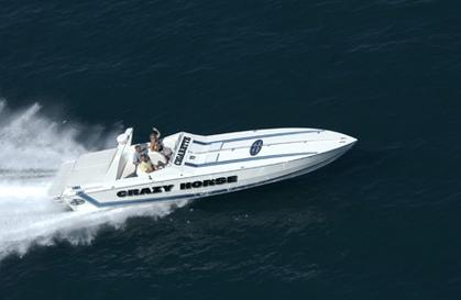

Thanks guys. Being able to use #6 props with the bushings may make it easier for me if I decide to change wheels in the future. Here's a picture of the boat on the last COPS run. That's Waterfoul with us.
