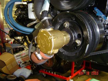

Dyno...as requested,
After looking at it I remembered the original design was for the hose connections should be on the right( looking from front) along with the bracket. I flipped it over to the opposite side and redrilled the bracet and gave it a little twist. Works great
Note the belt in place , ready to swing around and use incase the other were to break. The hose and bracket keep you from simply installing the belt as usual.
