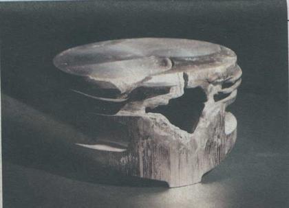

Lean is mean

Hi Dustin: I was thinking the same thing while reading this thread. There's only so much heat produced by compression of the air in the cylinder and only so much energy available in the fuel. So the number of BTUs is limited. If this energy is released smoothly in a nice "slow" flame front then the BTUs are spread over time and the conduction of heat by metal and cooling water has time to work and prevent hot spots.
Detonation is a very fast chemical reaction that releases all the remaining BTUs at once as noted above. Somewhere, usually on the piston, this results in the start of physical damage and then the hot gases escaping through this new hole concentrate a lot of energy in a small area with no cooling. This is a cutting torch.
