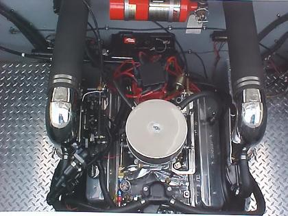

diamond plate flooring is SOOOO much nicer to work on. Level ground that you actally have grip on (when you spill oil) is truly a god send.
get a phoen book or try superpages.com and search for metal fabricators in your area. I had one order the diamond plate and cut andbend it for me. I material cuts and bending was less than $200. and I ordered a full 4'X8' sheet of diamond plate

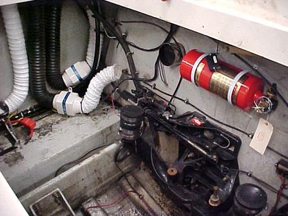

Go with the diamond plate....Eddie Marine can powdercoat it pretty cheap......
Before.....
