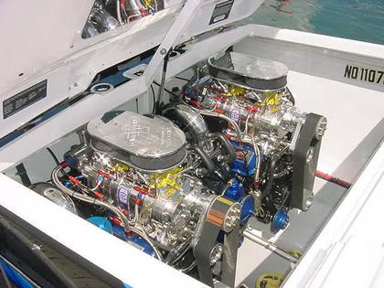

01 Tiger with XR's.....
Bulldogs with blowers....
2 seasons and only broke a vertical shaft, so far...
